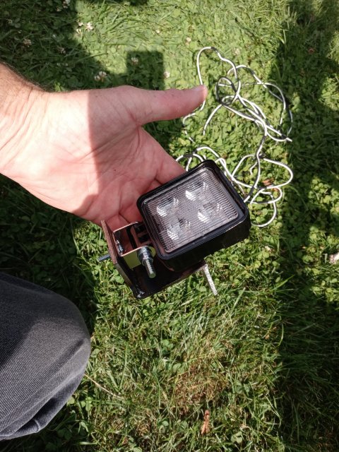

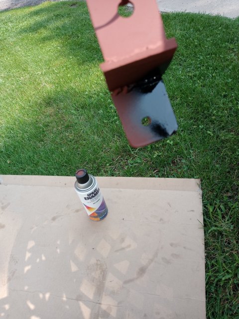

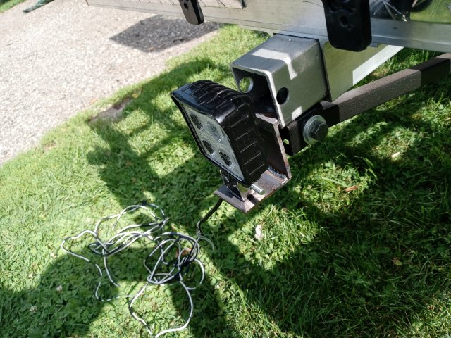

Last night I cut and welded a heavy duty bracket. Did some grinding and drilling to fit it onto the end of the basket tube this morning. The test fit looks good! So, now i am waiting for the primer to dry before I rattle can paint it and bolt it in place.
I will post up some night images of the effect of this addition later tonight.
This will conclude the project. I will put up some images of the setup unpacked and complete. I still have to do the auxiliary battery and low voltage harness to the tent that will give me led lighting and some limited 12 volt electrical possibilities. My goal is for three days of comfortable boondocking without a recharge. 20210730_171516.jpg

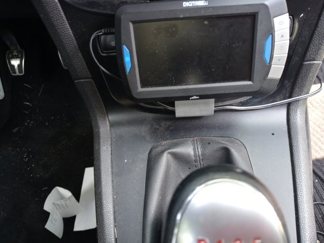

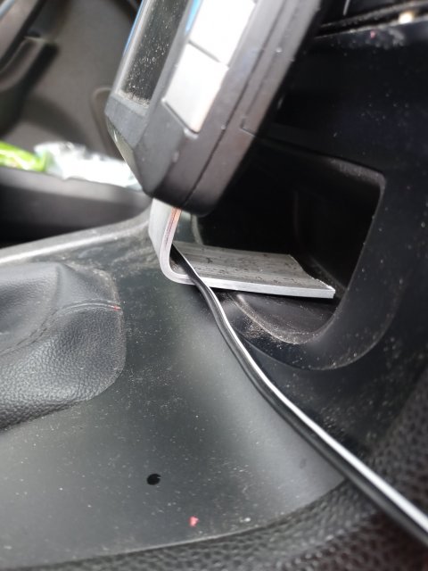

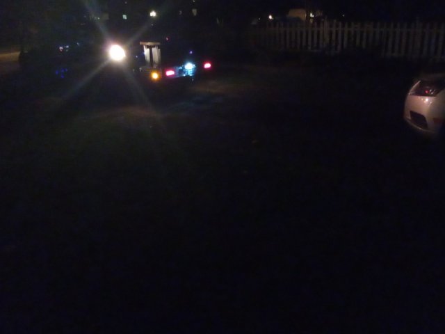

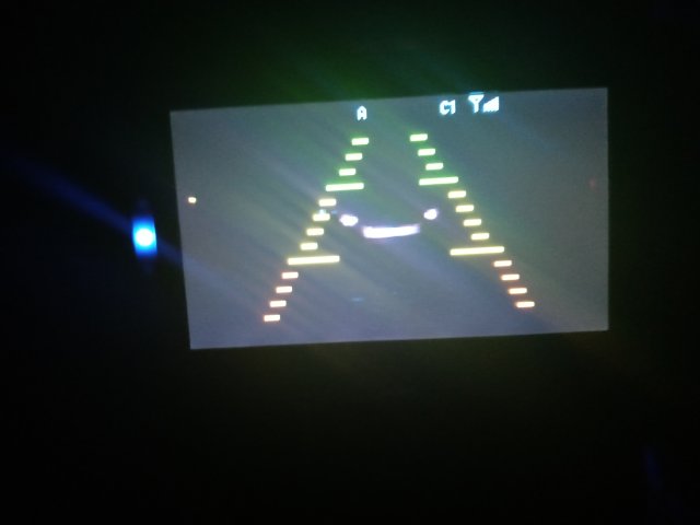

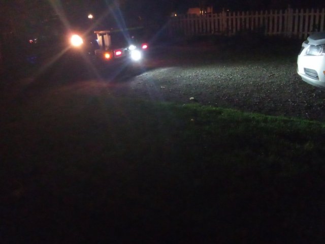

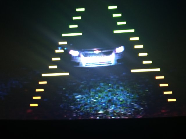

20210801_215840.jpg night images without and with the added reverse lamp. Screen images first then outside from 15 feet away with flash setting on phone camera at "off". I left the proximity grid on to show the vehicle position is not changed just my phone cam is not the same distance from the screen. Last two images are of the removable bracket in place for the camera screen. Just a piece of aluminum cut and bent to a usable angle and urethane double faced tape attached. I'm satisfied with the outcome of this project. I am curious about what anyone else is working on or thinking about in regards to a camping setup for the Fiesta. Post up the pics and questions in this thread! 20210801_220222.jpg 20210801_220202.jpg

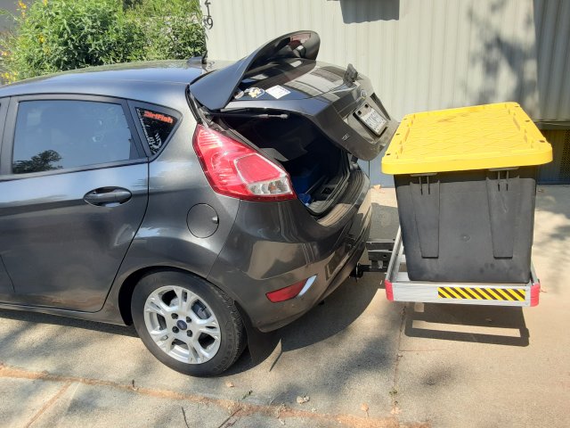

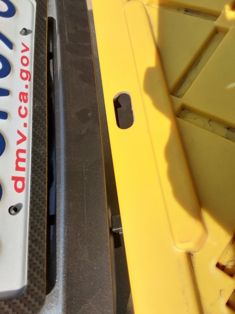

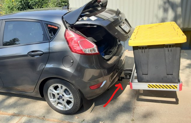

OK...I came up with a non-weld way to get my basket almost 4 inches higher at the back end. I bolted the basket bar to the top of the 2-inch receiver. Because of the reinforcement on the receiver collar that added a bit of pitch to the equation. This arrangement removes all the slop (x & y axis) in the 2-inch receiver and so no need now for the rattle clamp or pin. It brought everything in about 5 inches closer; I can still open the hatch with the bin in place.
Before...fully loaded.
Now...not loaded
View attachment 5448 View attachment 5449
Just wanted to post the pics of tailgate clearance with this setup. Going to do some housesitting which involves possible wildfire evac; so taking the empty box with me just in case.
#86
All good with the back of the car crammed with about 250-lbs of stuff; nothing in the box. The only thing that bottoms now are the too-long u-bolts. Gonna have to cut them down when I return home. One bonus with raising the whole shabam is now I can now see the top 3-inches of the box. No more wondering if it is actually back there!

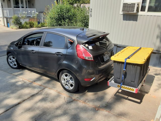

That's where i'm at. Picked up an aluminum carrier tray for just over $100 out the door at a local farm & home store.
I have a Curt hitch on the FiST.
I am weighing the advantage of using a good quality storage tote as the protection for the tent and some other things.
The 27 gallon one shown is a bit undersized. But if i can fit most of the gear into it i might just make a filler of Styrofoam sheet to set it into and stabilize the box. Then i can just strap it down. View attachment 4973 View attachment 4974
