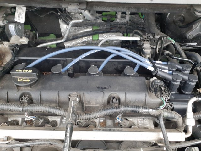

We had a new OEM clutch and flywheel recently installed and ever since we got the car back it's been throwing p0301 and p0304 codes off and on. Sometimes it's a solid light, sometimes flashes, sometimes the car behaves normally. The shop replaced spark plugs, wires and coil pack hoping to solve the issue but the light came right back. About to take it back for the third time and we're all at a loss. What could have happened, where should they look and how to go about fixing this? It must be related to the recent work but how?

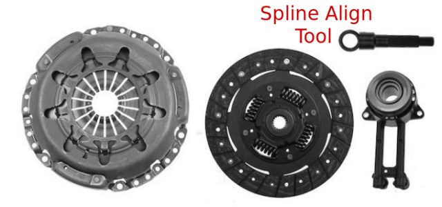

@Mercurios2011 - thank him, he gave you the biggest clue - after a clutch replacement - the OEM plate doesn't always need to be turned - but if it's bad, they have to replace it with an exact OEM one.
So not sure of the LUK clutch pack install had to make any changes to the flywheel you had used Originally - until this replacement.
Then too, if the whole transaxle and manual boxes had to be dropped to do this - the codes show it's highly likely it was not re-seated correctly.
This may also be giving you a sign that the clutch to wheel alignment might be a touch off. - There was supposed to be a insert tool that goes with this kit that aligns the pack to the plate - did they use the tool?
