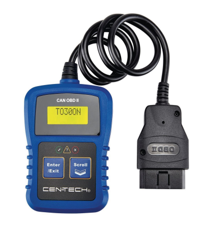

But, what I was refering to was a simple scan tool, like this
You just need to see your simple I/M so no need to spend a ton of money on something you only play with when the thing you install it on, is broken..
About $40 at Harbor Freight - Menards and others are similar.

Thanks found something similar here in the UK from Toolstation for £28'ish 👍
