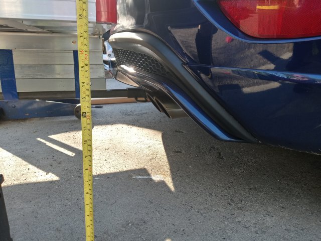

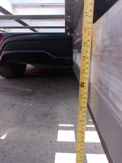

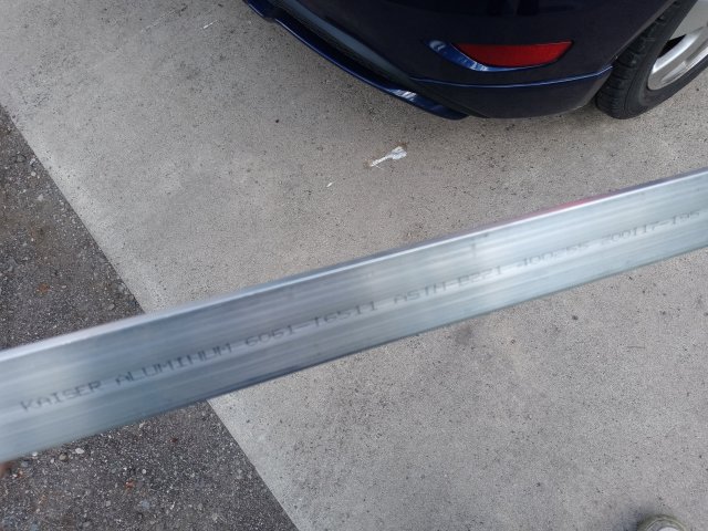

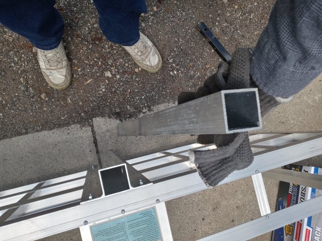

I finally got the time to post up the measurement pics. I am trying to mount the basket closer to the rear bumper and higher than the original configuration.
I bought the T6061 extruded aluminum tubes and 11 gauge steel tube remnants from a local metal supply store for under $40.
This just a height determination mock up. The riser components will be heliarc welded into a single assembly that will be bolted to a plate surface on the inch and a quarter receiver
tube. I also will be adding a pair of braces in the center on the right and left sides to stabilize the basket from rocking side to side.
I am experimenting. I am not altering the basket itself, only the attachment bracketing. 20210512_152155.jpg 20210512_150453_HDR.jpg

That looks good. Is it too close to the exhaust? Hard to tell from the pics. I have read where plastic bins get melted if too close. I know, for you, you want it tucked in tight...so looks like you got it. I also would still use the stabilizing bracket at the receiver. There is considerable slop up-down & side-to-side. I would be worried about side-to-side movement hitting the car...but again you are standing right there, so you can judge that.
1,973
Thread Starter #45
No. It's well above the exhaust outlet. I have some very lightweight, hi tech heat shield material i was planning to use. But, i feel good about where it's at right now. Originally, my reason for mounting it closer was to tuck the box out of the airstream so it wont be buffeted as i blast down the highway.

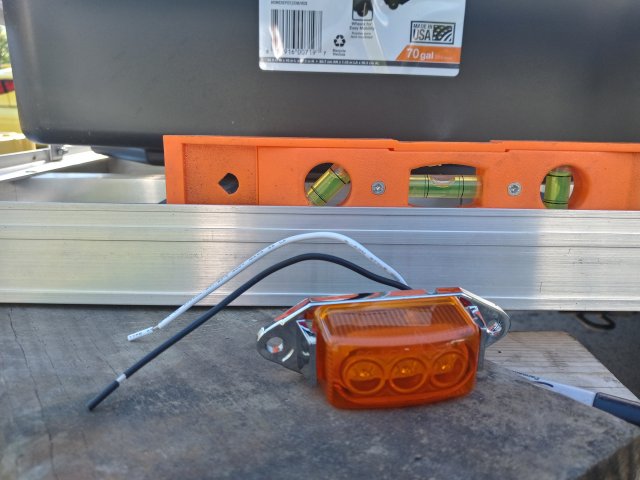

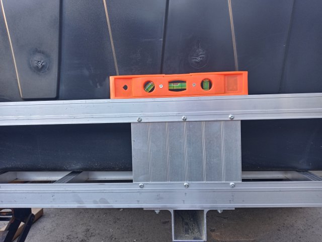

Im using this 2 inch wide by 1/4 inch thick T6061-T6511 aluminum flat stock for the left and right stabilizers. Haven't decided if i will heliarc the mounting tabs of the same material with stainless steel bolts and nylock nuts or just go with mild steel tabs and welded in place nuts for convenience sake. 20210512_164343.jpg 20210513_082714_HDR.jpg

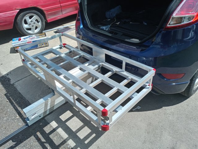

The last batch of "what if" images. I have cut the braces and sent them to a welding shop to get heliarc welded together. It's too much hassle for me to change over my mig welder to do that small stuff. Someday I will get a dedicated Heliarc setup.

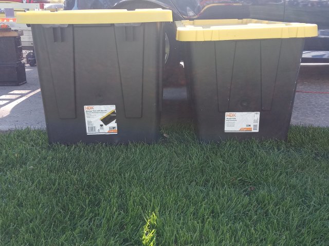

I had no problem with making this setup "level". I went with a 70 gallon HDX box, like Lions tooth has. The weight difference is just two point something more pounds than the 55 gallon capacity box i was going to use a month ago. The 70G box is only 3 inches taller and 2.5 inches wider than the 55G box.
I should have no trouble putting the tent, tarp, a pair of folding cloth camp chairs and a small table plus my hibachi grill in the big box.
Might have room to spare. I am excited with how nicely this is coming together! 20210513_082910_HDR.jpg 20210513_092050.jpg 20210513_071151_HDR.jpg
#47
For me, the 70 gal just made more sense. I "could have gotten away with" the 55 but for $5 more & very little size difference AND wheels, I had more capacity but also less stress about packing stuff "just right," so it would all fit. Now it will be more of a throw-it-in-and-go thing. I have used an HDX on my bike trailer, rain or shine, for like 6 years and I love these boxes. Even without the extra sealing tape, nothing got wet. At 65mph, I want the tape though! If I ever get back to autocrossing, this setup will be great for all the track stuff. Get to the venue, the box off, take the basket off, boom!

It's a slippery slope we are on! I am still well under my original budget. The added lights on each side , amber. And a pair in back, red. Plus the plate lamp and possible separate power lead to the camera would be a simple harness and two connectors. Not a big deal to do and almost no effort to disconnect.
If the big box were yellow and the lid black, i wouldn't be considering lights. Then maybe, a few strips of conspicuity tape.
The time spent considering the options and discussion about the best path forward is the most "fun" aspect of these threads! Then later, when something that I thought up doesn't work very well, everyone here will have even more fun asking me "what the hell was i thinking? " Or "what was i smoking?". It's all just great!

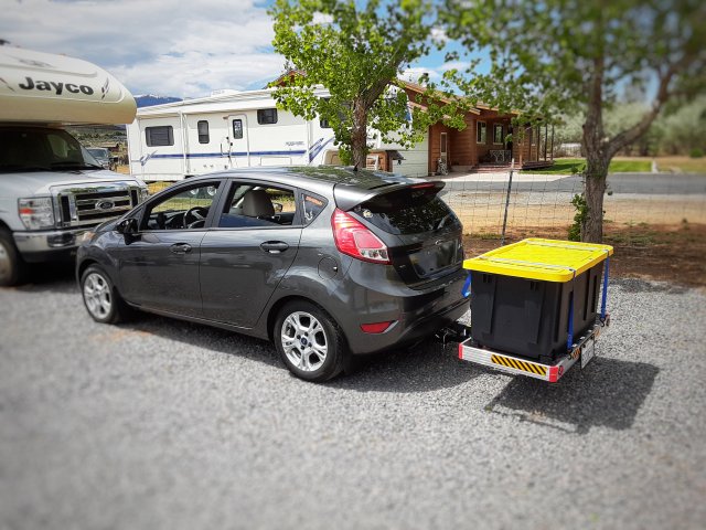

I just put my basket/bin on for a weekend road trip. Don't really need it, but I want to put 500 miles on the set up before I drive to Colorado. Choosing not to move the license plate at this point. If I get stopped, I will move it. Otherwise it's just a fix-it ticket.

Sorry. I missed the obvious point of your question! My reason for considering lights is more specifically for depth perception or making it very clear that there is something taking up space back there. Especially driving at night.
My thinking on the reverse camera is "what the hell". I have a couple of kits leftover from a work project. So, cost is nil. My decision to mount the basket much closer to the rear bumper would, to use a worn phrase, "bite me in the ass" immediately if i were to back into anything. A $500 bumper cover is a big motivator.

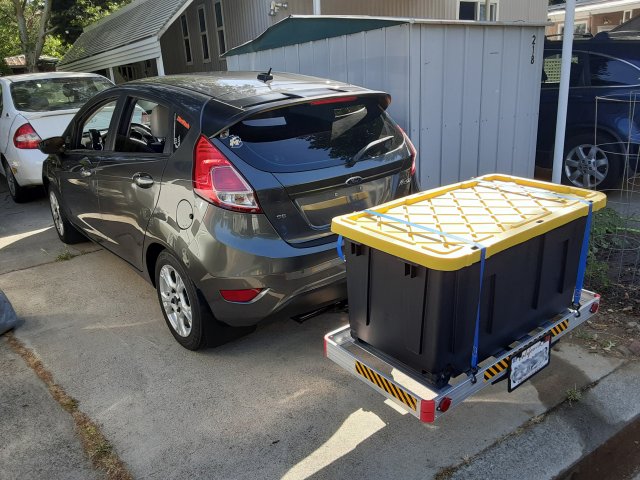

521 miles on the setup this weekend, and no issues. Had a ton of rain today coming home for about 150 miles and not a drop inside the box. Had it up as high as 95mph...can't even tell the box is back there. For my next trip, I will add a single strap across the opposite axis, just for my peace of mind.

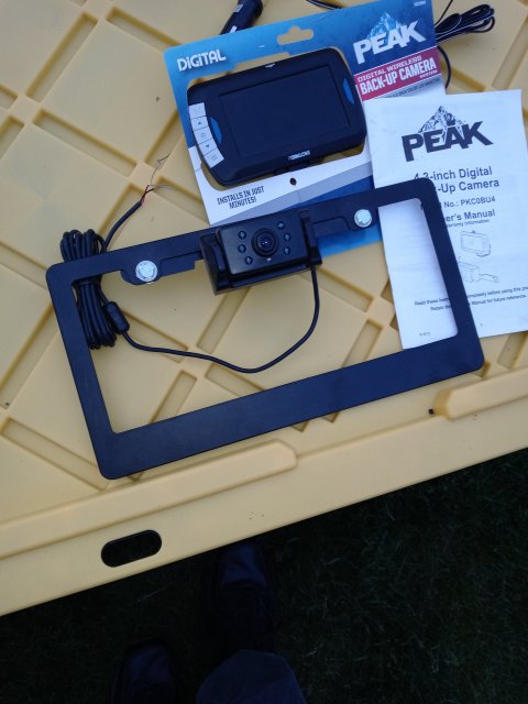

I am doing an install of a simple rear camera kit mounted to a metal bracket that also holds the plate. The high mounted position of my setup completely hides the plate.
Probably put this one in the exterior modifications area because only the camera location is different from a normal reverse camera install.
#60
Good to hear that it was a uneventful trip. It gives me the motivation to lean into wrapping my setup as soon as possible.
Hard-wired to the backup lights? Wireless reception? Link to your install and results, here....thanks!
