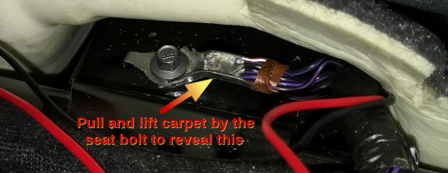

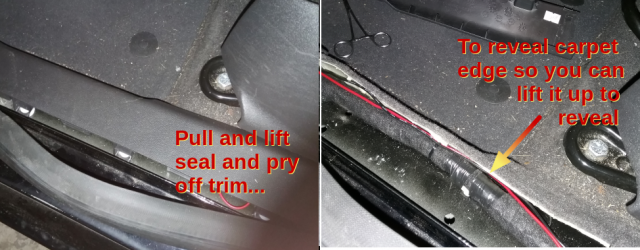

The speaking of Broken Ground wire is quite plausible - and you can do some simpler checks using a simple flat blade screwdriver to help lift trim and inspect a grounding point as there are several in the passenger compartment - with two at the front, one on the passenger-seat side and driver seat side.
These are where Ground wires from the main wiring harness route to and are soldered to a lug that then bolts the wires tied bundle lug to the frame ground.
Since these seem to be intermittent - they may be caused by vibration and rusted metal that makes/breaks/makes contact for grounding wire points.

Sorry for getting back to this late. I had a quick look at the ground points on both driver and passenger side and they look clean, although they only had one wire connected to them. I haven't had a chance to roll the window to dry the window compartments yet, so will give that a go. I have not been using AC that much recently but did use it during the summer for like a month.
I will probably have a dig around at ground points to make sure they are tight and good. I think I should have a multimeter lying around as well, so might give it a go after digging into the wiring stuff more. But do feel like I am better off taking to the garage whenthe issues arise again.
