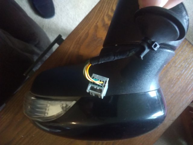

This LH mirror is a heated mirror with the signal. It shows 6 pin locations occupied. The wire harness in the RH door should have 6 wires to feed the mirror (my guess). If it does, a replacement should be an easy swap.

I noticed both mirrors, the heated/signal mirror and the normal one had the same 12pin connector. I figured at the very least, I can connect it and the mirror motor should work, so I ordered the heated/signal mirror (at least the mirrors would now match and not look stupid, lol!).
The wiring in the door had 6 wires, like the mirror above (I didn't think to look at the mirror being removed, should have). Hooked it up, everything seems to work as expected (motor moves, signals work). Not 100% sure on the heating, the icon on the mirror (either of them) didn't light up, is it supposed to? We turned the rear window defrost on, that's what activates the heated mirrors according to Google. My Hondas heated mirrors lit the icon when on, and also had a dedicated button. They did seem to get a bit warmer, but that may have been me. In any case, this is San Diego, rarely, if ever, need heated mirrors.
It's also possible the body shop used an empty door shell and brought the harness from the wrecked door over (the car originally came with the heated/signal mirrors). Really no way to know for sure. So, I'm not sure if it was truly pre-wired or not. Given my history with Fords (Mustangs mostly), I'm guessing it is though.
It took all of about 30-40 minutes in my work parking lot at night, while teaching the owner a little about cars in the process. Not as easy as my Mustang, but still very simple.
