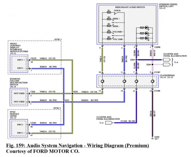

I don't know if this is related to the issue but the buttons on the steering wheel were not working other than cruise control, while vol & next buttons weren't so i decided to take it apart to clean it, I managed to do it without removing the airbag, after i reattached it presto! all the buttons were working. fast forward 2 weeks my traction light comes on dashboard on a dry day which i found strange & now it wont go away, decide to take to halfords,who didn't have a clue what to do other than give me card to a diagnostic specialist who examined my car with his over £2000 equipment but couldn't find any error codes. I'm out of pocket for 2 diagnostic charges now & I am reluctant to pay for another, the issue I'm having is engine power is reduced when the traction light is on, I cant accelerate uphill. Sometimes the traction light comes on immediately starting the engine & turning steering wheel, other times after 5 min drive, but as soon as it comes on engine power is reduced a message pops up saying engine failure service now. any help or similar experience would help. thank you...

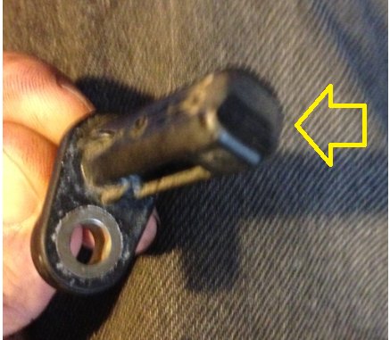

Sometimes the abs wire gets a lil nicked , or the hub gets so covered in mud it won't read right :LOL: ,you can inspect the wires yourself and look for kinks ,nicks , splits or maybe even broken.
for best results in my experience just replace as whole unit

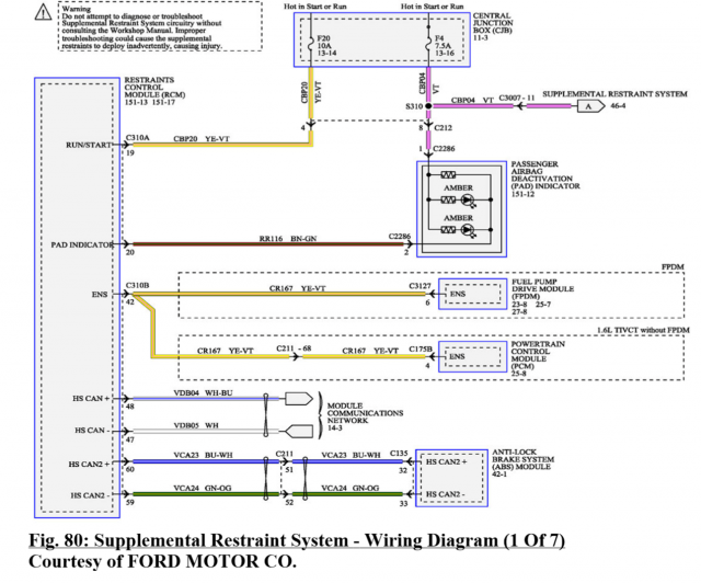

But it's the U0401 from the ABS system - has me concerned...
The ABS is questioning the validity of PCM data - it's losing host communication.

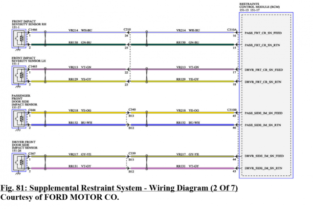

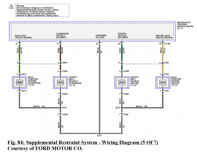

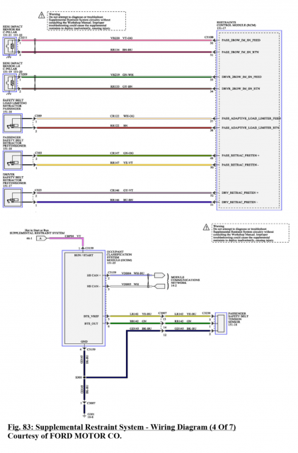

So that could turn on a TRAC light - gotta take apart the console and look for the RCM module - it's right under and just in front (or behind it towards the rear if your looking from the drivers side at the shifter) of the shifter. You have to go over the wring - that Airbag unit also is working with the Restraint system to detect and offset the loss of traction and changes in direction of the vehicle is can sense as part of its SRS (Supplemental Restraint System - or AIRBAG) so that one module interconnects all those airbags and those impact sensors - and use the High speed CAM side to communicate to the Antilock braking system.

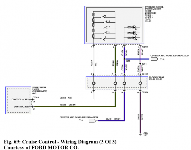

As I was going over your post earlier - I also need to mention about the work you did to the Steering wheel to get the audio functions working again. There is a 2-section wire harness that interconnects the wiring in the steering wheel, with a STATIONARY connector that bolts to the steering wheel column then it goes into the wiring harness and branches off from there. The main harness that is stationary is brought to the side of where your high-bean and flash to pass column switch is on. From there it turns into 1 dedicated Airbag harness and another smaller "Y" breakout harness for the Audio and Cruise control.
IN mine the second piece of these harnesses, the Airbag harness is yellow sleeved and connects to a blue box connector - while the other functions like Audio and the Cruise control - are through a 16-pin connector - again mounted by and at where that Airbag harness goes.
These two thread thru the main steering wheel "well" that houses the clockspring - this helps center the steering wheel - the sleeved wires are just long enough to let the wheel spin equally in either direction without pulling the wires or their connectors taught and doing damage - yanking them out.

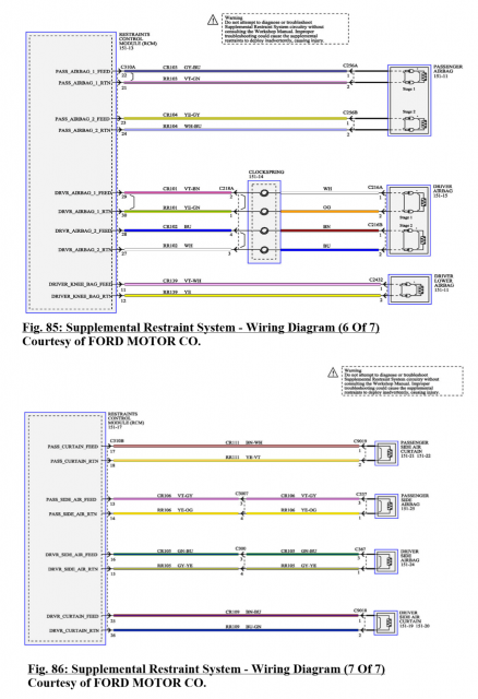

The ABS airbags in the main horn section - you have two bombs wired to go off to inflate the main steering wheel airbag - so if you have done work to the controls on the steering wheel, this can affect the wiring - not necessarily there, the clockspring would and can still damage the harnesses that are designed to take the twisting of the steering wheel and survive for the lifetime of the steering column and wheel.
So just double check your wiring fix so you can avoid more damage to the system - the other part is with the SRS/RCM (Restraint Control Module) - that module is the one that looks at and communicates with ABS module at the ABS system inside the engine compartment.
So just verify you're not scraping or scuffing a pinched wire somewhere...
