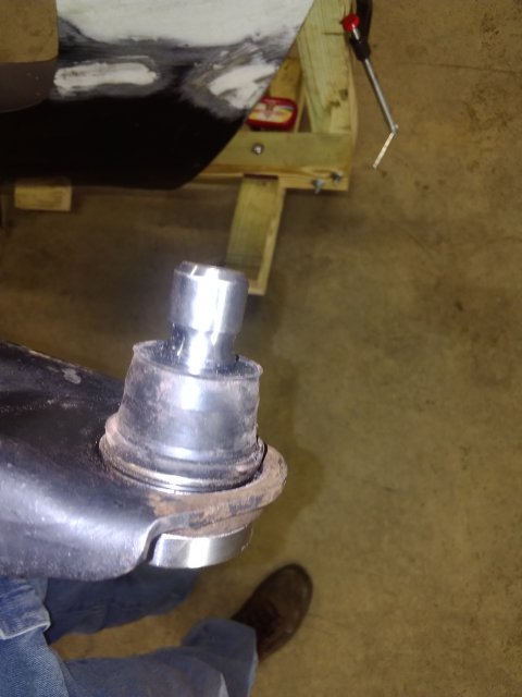

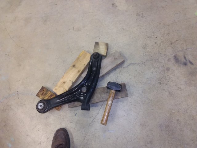

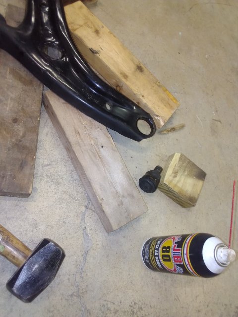

Ball joints are first. I used a few scrap pieces of 2X4 as a cushion for the control arm as I drive out the worn ball joints.
New control arms are not very expensive (approx $65.00). But, I think it's a better deal to get new ball joints for $20 and then knocking out the old bushings. I don't think that putting in just new poly bushings and keeping the old ball joints is a good idea. Everything should be in top condition if you are interested in doing a bushing upgrade! The cost of the new ball joints is a minor expense and a major part of the upgrade to get precise handling.
I used a fine wire brush to clean the perimeter of the ball joint and then sprayed it with a penetrating oil, in this case JB-80. It's a little more oily than WD-40. The joint was knocked out with two good hits.

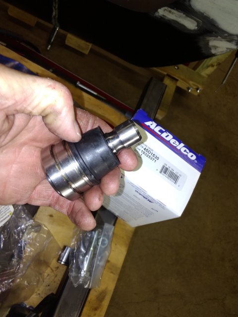

The first image is the new service replacement ball joints. AC Delco # 45D1530. They are not designed with zerk fittings, I couldn't find any aftermarket joints for the Fiesta that had them. I really wanted that feature.
Anyways, these were very easy to install. They include a new bolt and nut for the knuckle and also had a external snap ring, O.E. do not have that. So, these might be a little easier to do because the tolerance is not as tight. They did press in snugly and I had no issues with putting the snap ring on the joint.
The second image is the joint being pressed into the arm. I think a large C clamp and a deep socket big enough to clear the ball joint would have been just as good

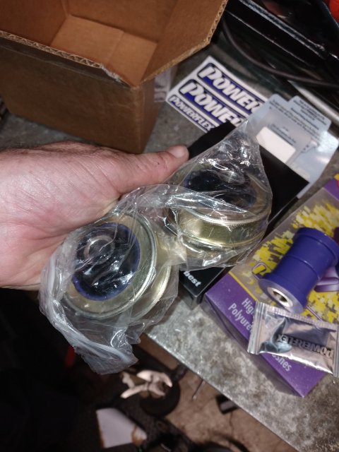

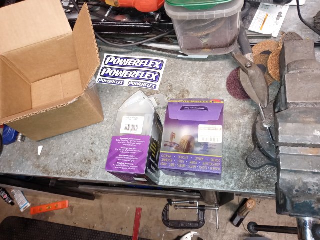

My delay on the bushings is a confusing situation with what I ordered and what I got. I got twice the quantity of what I ordered for the position #2 bushings. So, two of those were returned. But I'm short on the position #1 bushings. So I'm spinning my wheels at the moment. I was planning on using Powerflex. But I might be able to walk into a retail store in Toledo and walk out with Whiteline. I will need to get moving on this soon, I need to get this done and on to the next thing. I am literally trying to check off a task list!

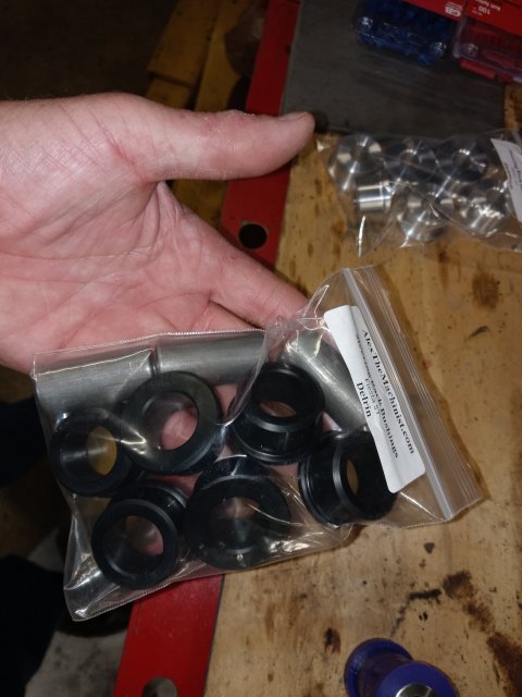

I didn't use those rack bushings for that reason. I'm not going to have slicks or shaved tires. I believe that the tread squirm/slippage would give me some compliance. If you guys are interested in what those bushings would be like I can do them! It's not an expensive thing and looks very simple to install. I have another rack on the shelf that I can swap out if the solid mounts are too harsh.
It will be several weeks before I can post the install of the rack bushings, the website says that those parts are made to order.

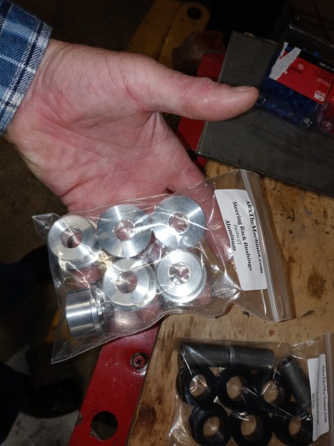

I ordered up those rack bushings from Alex last Friday. So, we will see what they are like! I will make a separate thread for that one.
I have received both sets of rack bushings. I will make separate threads for each at a later date.

Both! I am using the Goldilocks method. Because i simply don't know which of them , if either, would be both an improvement and tolerable.

Thats where im at. The Delrin bushings were not unreasonably priced. So, I decided to avoid more waiting in the future and just have Alex whip me out a set of each.

Ok! I have the Powerflex bushings on my bench! Plus i am not working this weekend. So i will do an install of the two remaining types of control arm bushings. 20201001_130658.jpg

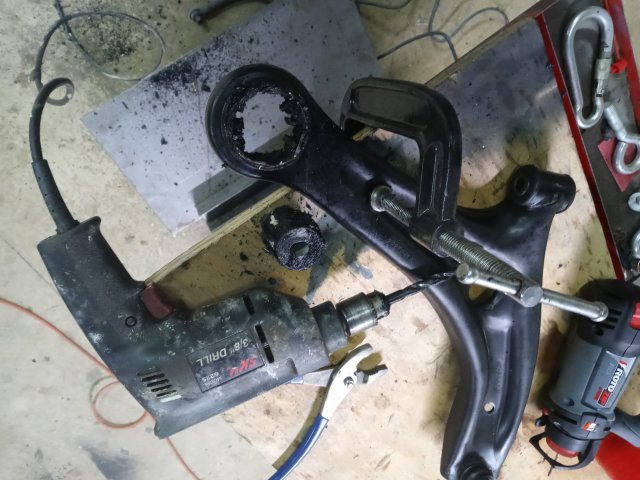

The large inboard bushing with caster adjustment is first! I dont have a properly sized and clearanced drift tool to press this huge bushing out of the arm. So i took a drill and hogged out the rubber part around the spacer. Then i carefully used an air chisel to break the shell of the old bushing enough to dislodge it from the control arm. I hate this method! Drilling the rubber is a mess. I'm trying to do these installs with tools that are either commonly had or cheaply bought. But i will only use the pro equipment if it's really necessary.
Pic 1 is the hogging out of the rubber part. Don't wear clothes you care about! The rubber is sticky and leaves black spots on you and your clothes.

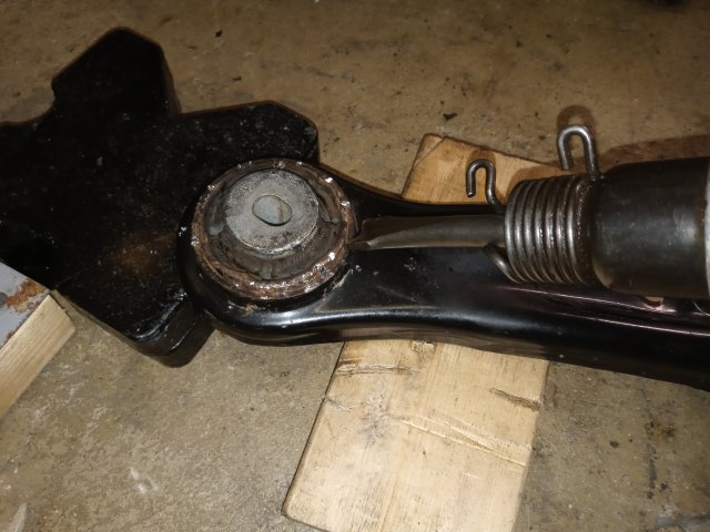

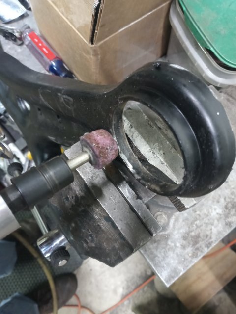

Pic 2 is of the shell of the bushing just knocked out of the arm. I couldn't get the air chisel shot to load, yet. I slightly dinged the top edge of the arm where the bushing comes through. So, in pic 3 i had to carefully clean up those nicks with a die grinder. A curved face metal file would also work perfectly on this.

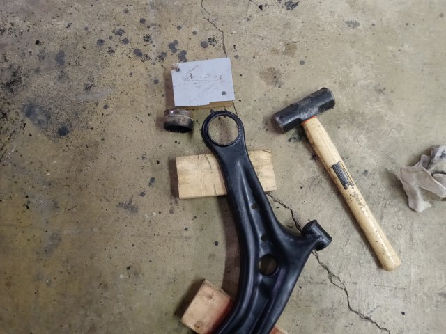

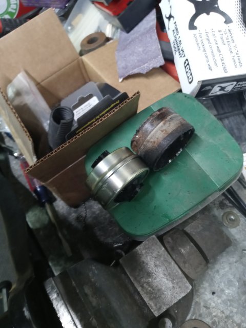

The 4th pic is a comparison of the old shell and new bushing. This bushing must be located or clocked in a very specific direction in relation to the ball joint on the other end. Powerflex provided a diagram in pic 5.
