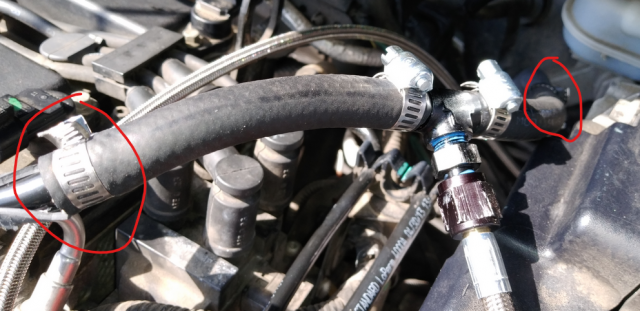

Mmmmmkay....use whatever you guys want but I ended up just getting a 5/16th OD high pressure fuel hose. The got a NX 5/16th barbed T fitting and clamped everthing.
My only concern would be to not have flanged ends on these tubes to retain the hose from slipping off. Don't know the fuel pressure there but over time, as the clamps seat into the rubber it will loosen the grip and the flange would provide some safety from the hose just slipping off the tube. Could be overkill, but I have experience with fuel hoses coming off and pumping fuel onto the hot manifold and it's instant fire with not much chance of putting it out before a bunch of damage is done.

I'll be keeping a eye out for sure. Probably just needs to be routinely inspected which I believe I'll be doing once my systems ready to go. Making sure lines are tight and yada yada.

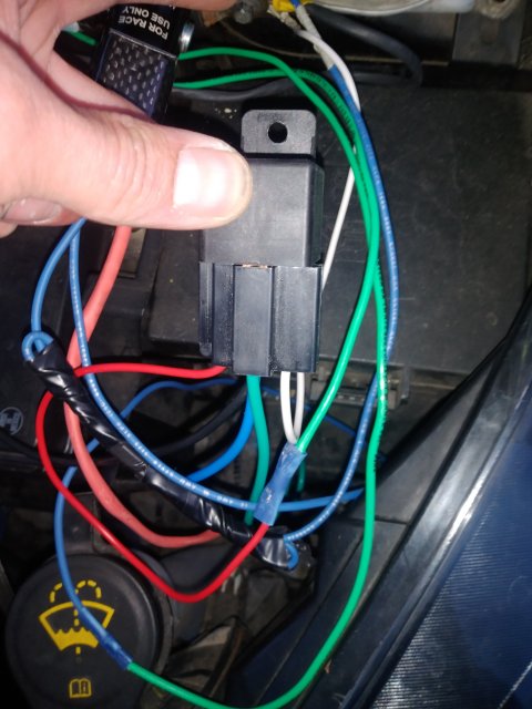

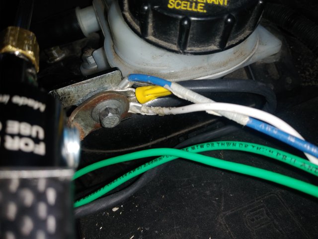

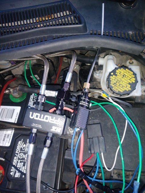

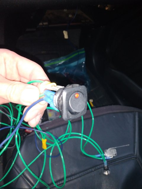

Got bottle gauge put on and filled. installed purge kit with everything wired. System works and purge is bitchin. Still need AF gauge, colder plugs and I'll be making hits. I'll get pics of wiring and video of purge.
