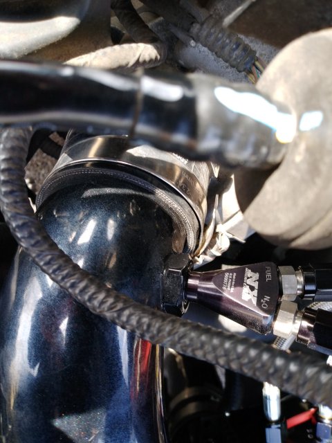

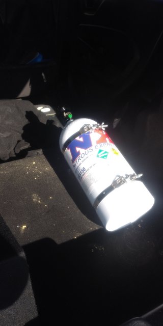

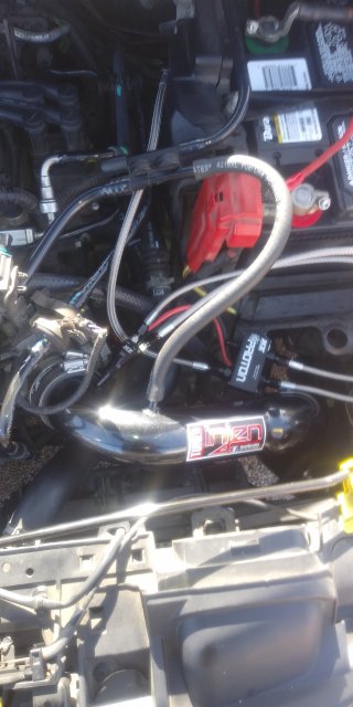

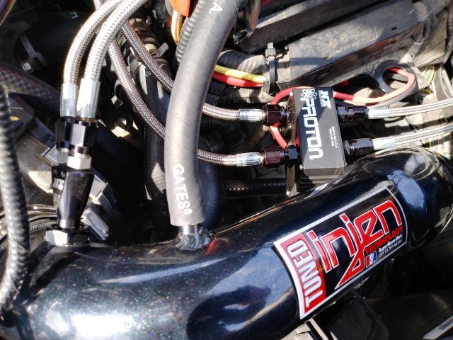

Anyways.... This is the location I put the shark nozzle and the module. Bottles mounted on the passanger side I just need to find a way to route the No2 line to the engine bay.

Here are some closer pics of were I put nozzle. Drilled a 9/16 hole with some rtv sealer around the bung in my intake....i cringed a bit. Still need a TPS/RPM window switch and a purge kit. Then I should be ready to rock and roll.

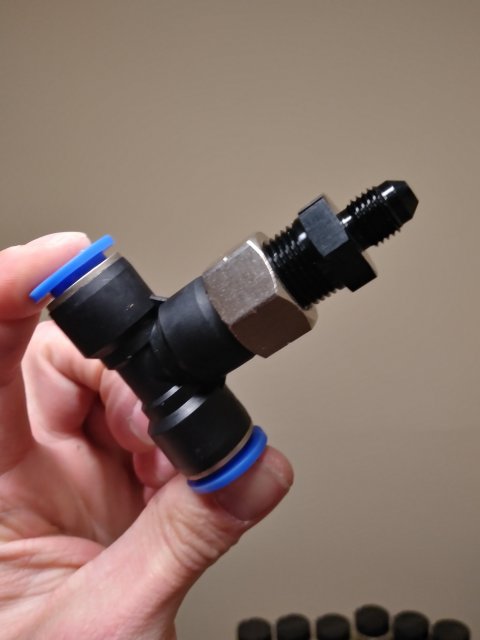

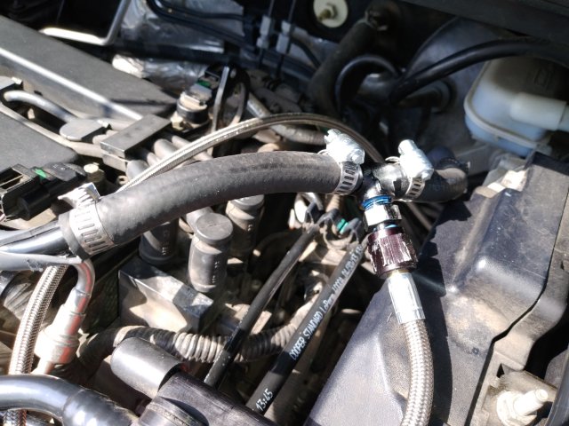

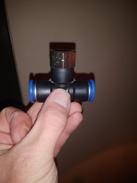

Sorry guys for the slow progress....but heres the update. I got the push connect fitting and i think it'll work. Im waiting on a 3/8 Npt to 4an adapter then im gonna cut the line. :eek: and just so yall know our fuel lines are nylon.

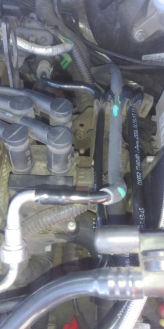

I feel like a fool...its not half inch. Ugh. I cut off a piece of hose from my intake and it was 5/16 to make a temp union till I get a 5/16th push connect. Minor set back but assuming your engine is a 1.6l duratec the fuel line is 5/16th OD
3/8 npt to 4an adapter. Cutting line tomorrow.

Mmmmmkay....use whatever you guys want but I ended up just getting a 5/16th OD high pressure fuel hose. The got a NX 5/16th barbed T fitting and clamped everthing.
