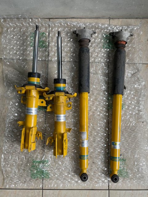

#28
Hello every one. It is my first attempt on a forum. I am Taiwanees, please forgive me bad english skill.
i'm wondering to know what coil spring will you suggest for bilstein B6? the FRPP spring will fit the B6 and work well?
here is my situaction
My car is Fiesta hatchback(CB1/CCN) 1.0t with automatic transmisson(south pacific asia version). This version use the same front Shock and Coil spring with Mazda 2, not Eour or Us version Shocks.

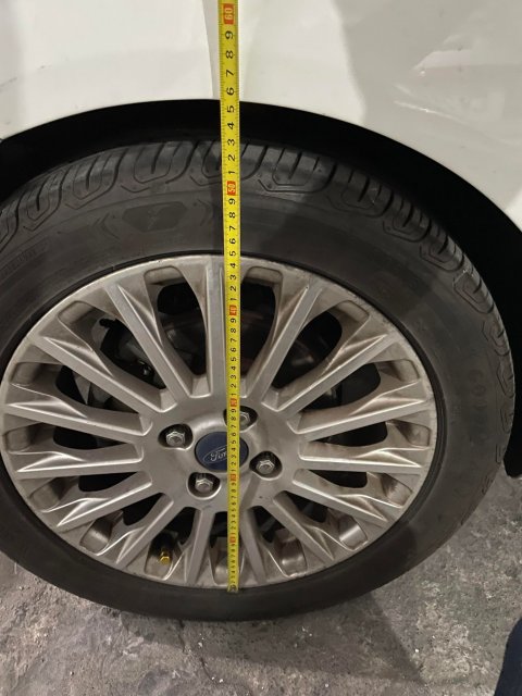

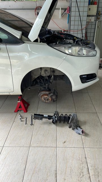

I bought the brand new Bilstein B6 Shocks (22-245199+22-245205+24-239318) for upgarte my suspension, but the Front OEM spring of my car is not fit for this B6, so i bought the Fiesta 1.4 automatic OEM spring(part no: 1547179(F)+1523225(R) for insteall.
After finish install, i go test drive, the car feel very stiff and bouncing, uncomfortable. After 4000km drive, i decide buy the FRPP handling pack (M-FR3-FA) to change out the B6. But FRPP is too soft for me....the handling of Frpp Kit is terrible, i want Change back B6, so i want to know any suggestion spring for B6?
best regard

1,972
Thread Starter #29
Hello Lorenzo. Is the problem in the front struts only? Does it ride hard primarily at the front? Please post up a couple of images of your dampers on the car.
B6 is a firm riding damper. The piston is larger than any of the other struts we have found.
The FRPP kit is the base European spec for mk7 and 7.5 fiesta. And you are right, it is on the softer side of the scale of ride quality.
What is your intended plan with this? Are you just wanting to renew the suspension? Or are you wanting a firmer, more controlled ride? Or are you wanting to lower the ride height?
Also, what size and type of wheels/ tires are you using?

#30

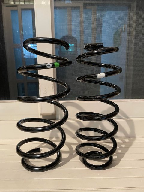

Hello Scotsman, Thanks for getting back to me. Fiesta 1.4(at) oem spring combo B6, make stiff feel problem happening in both Front and rear, especially rear shock. Some times,when speed go 80km up, i feel my car were bouncing back and forth.
As a daliy driver, due to bad road quality in Taipei city of Taiwan, i don't want make my shocks too stiff or harsh; but also want improve more controlled ride than oem shocks. So i plan my car can get the blance in ride comfor quality and handling, the ride height can keep or dont lowering too much(1 inch maxima).
I have tried changing the B6 to a FRPP kit, but FRPP is too soft for me
Is it possible to use the FRPP spring go with B6? the Front FRPP spring(Left green white dot) and Rear FRPP spring(white dot)
i use the oem alloy rim 16*6.5J with Goodyear ATM2 195/50/16(oem size)tyre.
Regard

1,972
Thread Starter #31
Ok. I am understanding more clearly now. The FRPP springs should be ok to use. They are not a heavy duty or performance type of spring. Your problem with spring and strut/shock choices is exactly why we have begun these brand specific threads. Everyone is trying to get a good choice for their fiesta. If i were you, i would adjust tire pressures closer to the label on the door jamb. The tire max psi statement on the sidewall is probably several bar greater than the door jamb decal. Try lower tire pressures in rear first. Fiesta is not very heavy in the rear. Small tire pressure adjustment can make noticeable ride quality improvement!

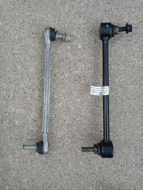

In front, i would be looking at the tire pressures and then also inspect the anti sway bar end links and the frame bushings on the subframe. Those endlinks are not the best thing for long life on rough roads. Those are very good images you posted! Please keep us updated here!
The silver end link below is the Ford original part. Not so great in rough road conditions. Black one next to it is a replacement part from Moog that is much stronger and is Grease-able as well! I think that those Moog parts are offered in Pacific rim markets too. Not sure. 20220706_191829.jpg
derosa129
Taipei
Taiwan
Fiesta 1.0
#32
Appreciate for your detailed explanation.

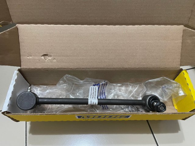

I've tried adjusting the tire pressure and also already upgrade STABILIZER LINK ,Great minds think alike ,i chose MOOG , higghest CP product of aftermarket part.
i got those from ROCKAUTO.
Unfortunately the bouncing and uncomfort problem still bother me.
Has anyone tried FRPP spring with B6 combo?
or
Suggestion any spring for B6 combo for dailt use ??
By the way, has anyone tried to put ST Fiesta lower contral arm on the Non-ST Fiesta hatchback? Does it help with control?
1,972
Thread Starter #33
FRPP springs on Bilstein B6 you will be the first! I am sorry I can't give you more insightful advice. But, we are just recently starting to look at and get ideas about what the various brands are like on a given spring.
The Moog links are a real bargain!
Fiesta ST lower arms are not an improved part. Eurathane bushings and new ball joints are a bigger upgrade. But if you want a soft ride they will not make you happy.

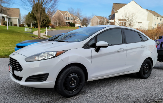

Hey all, I posted briefly about my desires to increase the ride quality of my 2015 S-model sedan with 80K miles in my intro thread.
I previously had a GTI, and now a new Camaro, so that is the type of quality and compliance I'd like to find if possible. Planted yet not jarring for my 150 mile round-trip commute.
I am pretty sure I want to go with the Bilstein B6 shocks/struts, or possibly the B8 if there's a great choice of matching lowering spring that would necessitate the B8 instead of the B6.
Is there a better-than-OEM spring @ OEM height that would give the ride I'm looking for? Or a lowering spring of ~1" that would pair with the B8?
Still need to dig into spring isolators, the boots, the bump stops, shock mounts, strut bearings etc. Lots of options on Rock Auto etc, as well as aftermarket.
