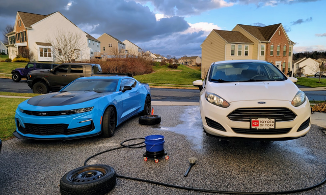

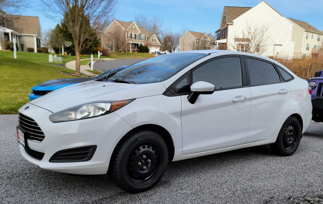

2015 Fiesta S Sedan
Daily beater, especially in winter.
Hoping to get it to ride a bit better and be more tolerable to drive.
80K miles, 5-speed. Great gas mileage.
I'll be scouring the suspension forum first.
