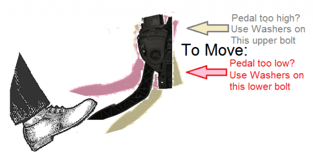

If - for some reason - the store in Melbourne can't help you - you do have options as a DIY.
The typical throttle pedal or Accelerator Pedal Position Sensor as Ford calls it, you have plenty of room not just to add a spacer - as suggested in this thread that lifts the pedal forward a set amount.
This works to some degree if the other pedals are setting too far forward. But this also affects how much you rotate your foot on its heel to adjust that pedal to find the right amount of throttle.
If you apply too much throttle - you will have to feather it and makes many uncomfortable that it needs too little to obtain the drive - having to lift your leg - or in some - rotation of the foot on the heel is not enough and you have to lift the foot to press weight on the pedal and the car leaps forward.
IF you just need more or less sensitivity - then perhaps a washer or two is all that is needed.
You adjust the angle the pedal rests at...by using a washer behind the throttles mount - on one of, or both of, the bolt(s) to the baseplate the pedal rests against.
This is due to the larger holes the (OEM) pedal sensor has for mounting, so it can give you some ability to tilt the pedal several degrees up - towards the foot or down back, towards the firewall or floorboard away from the foot.

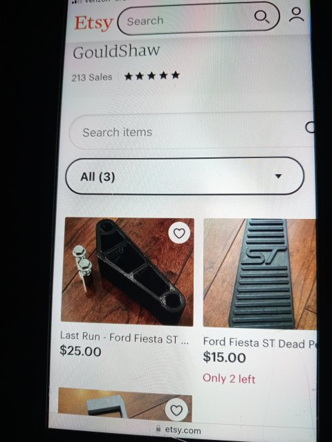

There is this one! Available from the GouldShaw store on Etsy. $25 bucks USD.
I have purchased items from all over the world.
The shipping cost won't be too outrageous. 16649271441786204802083484412057.jpg
