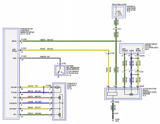

The accelerator pedal failure is not common. It’s not a high voltage sensor. So, it isn’t an item that gets very warm as a consequence of doing it’s job. I’ve seen a couple of them that the failure exhibited itself by having one or more dead spots in its operating range of motion. It’s just one of those things that occasionally happens.
The pedal (Accelerator Pedal Position Sensor - APP) uses two separate outputs from two types of power supply. One for the PCM, which is that Pulse Width and the other is a simple resistive range.
You Gotta' be careful, because one power supply feed is directly fused to the "Hot in Start or Run" section of the Engines' Fuse Box to power the side of the pedal that uses Pulse Width (a method of averaging is done back at the PCM) modulation signal (that whine you can hear from the engine when it's off - as the throttle body "seeks" that setting) as you modulate the pedal.
A second power supply is the HS CAM - so that is low voltage 5V logic stuff and is a simple Resistive result send to the Instrument cluster - that power is supplied thru the Body Control Module.
So in reality WOT is all that the system needs to attain, so that can get set from 70% to all the way up 100% - but the results you see on the HUD is what it thinks it is - then that is dependent on the results the Pods see from one side of the sensor, not necessarily what the PCM is setting the throttle to - that feedback is pre-set for the PCM to worry about.
Best way to check is to remove the snorkel and have someone move the pedal to various positions and call out so you can shine a light into the throttle body bore and observe the plate and it's position.
