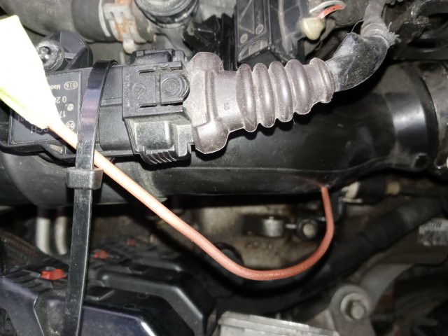

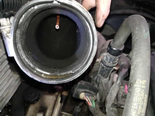

What if there was a "port" or nozzel built into the intake tube that would allow the technician to introduce the cleaning chemicals directly into the intake system of a running engine?
The pictures in the next post are of the intake tube modification on a chevy Cruze that will be the guinea pig for this idea.
