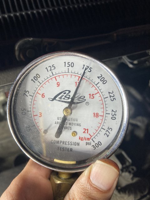

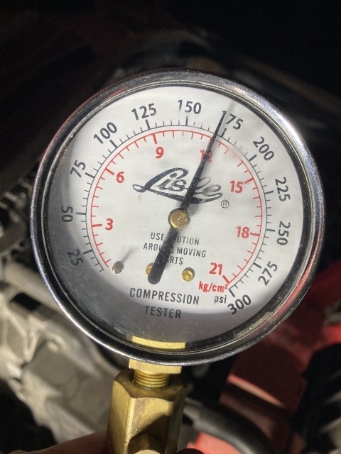

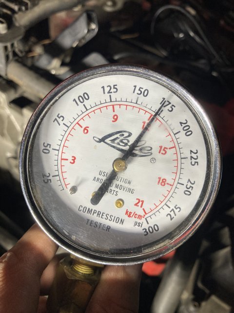

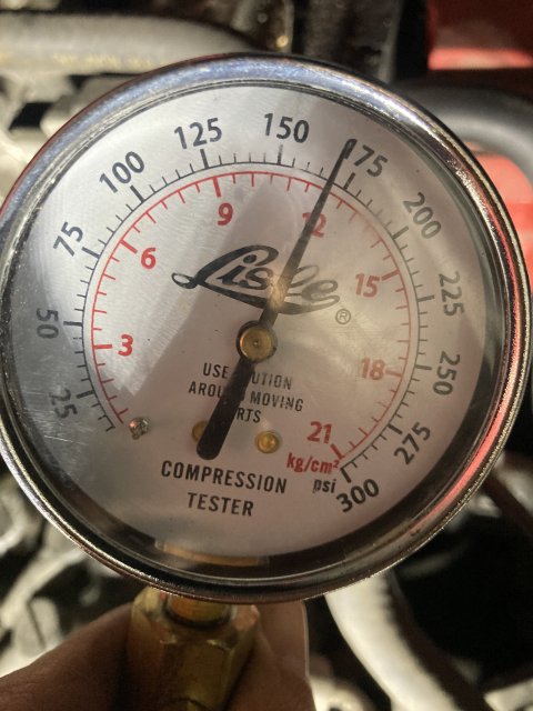

All cylinders had around 175 psi but only cylinder 1 was at 175. The rest were slightly below. However, I started the by getting 3 readings on each cylinder but the battery started to die on the first cylinder. I hooked up the battery charger and finished the test with just 2 readings on the last three cylinders. So, not using the full capabilities of the battery may have caused the compression to be a bit lower in the last three cylinders. All were very close tho.
Cylinder 1
Cylinder 2
Cylinder 3
Cylinder 4
This seems very straight forward. Not sure what to think of it.

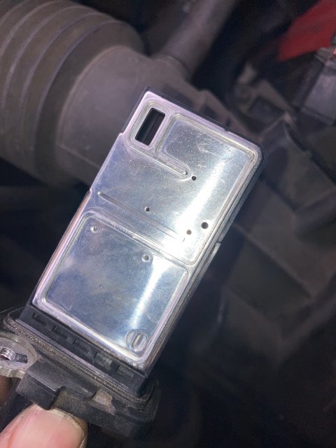

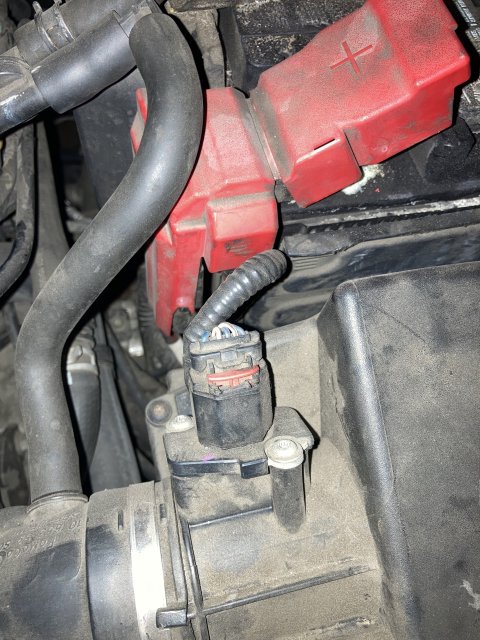

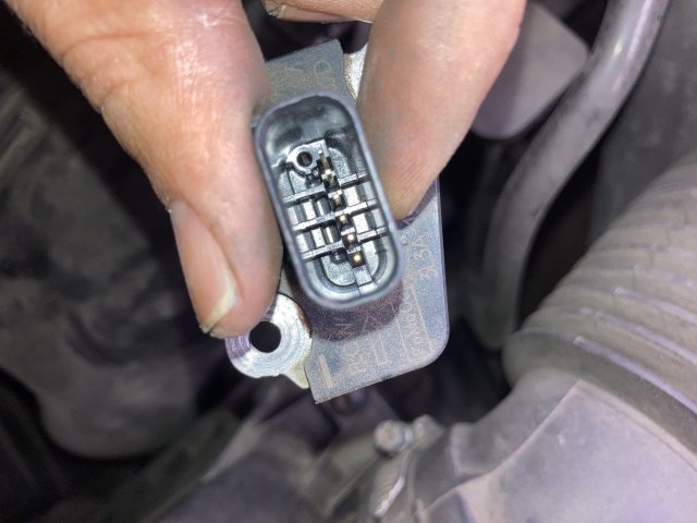

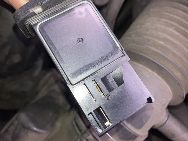

As for the MAF sensor, I checked it and it didn’t seem damaged at all.

Hey @Handy Andy The connections are pretty bad. I’ll give them a cleaning next time I work on it and check the date in the battery.

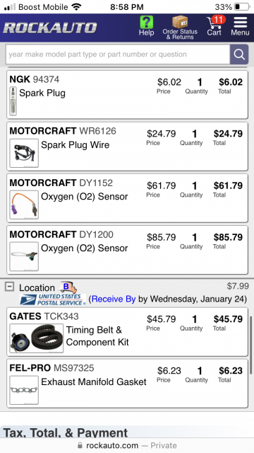

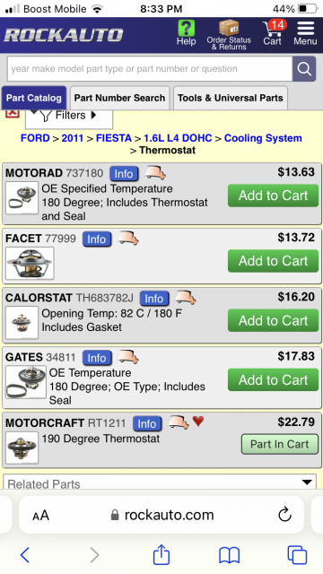

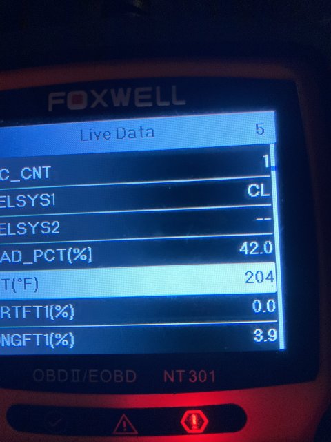

I just got out of a mechanic shop. According the the obd reader, the car was overheating. I saw and it got up to 230 degrees. Also, the fan is bad along with the fuse. They also said the cat needs to be replaced. It’s just old. I’ll need to replace both o2 sensors to pass smog as well.

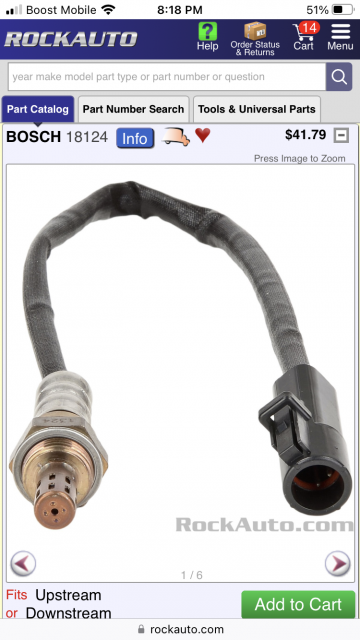

Im ordering all the parts tonight. My question is, do you think I can get away with a Bosch o2 sensor? The below says it’s good for upstream and downstream. What do you think about not going with the originals?
Also, does it take a 190 or 180 thermostat? The Motorcraft is a 190.
let me know what you guys think.

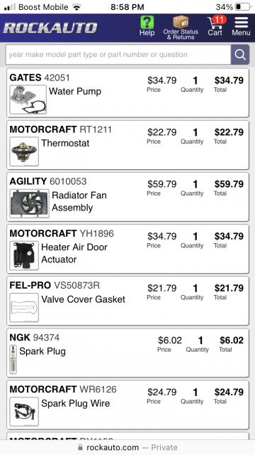

This is everything I think I need except the belt that runs the water pump. I can’t find it. Can someone help me out with that please?

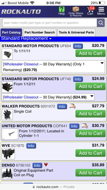

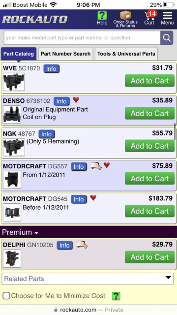

Also, what do you guys think about changing the ignition coil and what brand would you suggest?
832
666
#33
Motorcraft (OEM) is what it comes with. That's expensive, though.

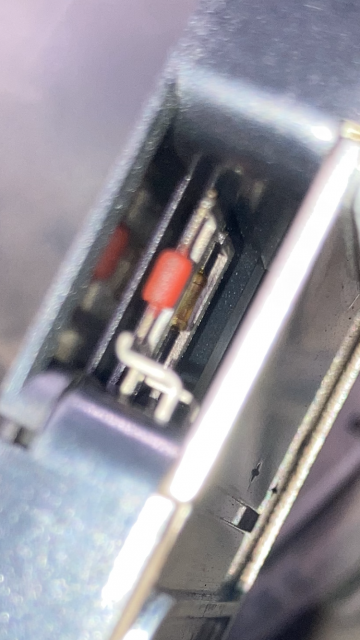

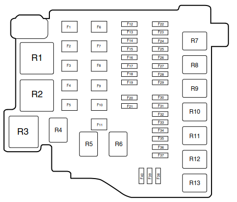

Just realized there’s no fuse in the R7 spot of the fuse box. That’s the spot for the cooling fan. Can someone tell me if this is a 20 amp fuse? I stopped my autozone when I had a little extra time and they didn’t know.
1,906
1,356
#36
I recommend 40 amp - that is what my Fiesta (2018) uses. Square (Insert) Cartridge type
If you have the older 2011 Fiesta - that has that "wedge-shaped" fuse box in the engine bay.
R7 spot is the one for that 40A relay.
Surprised that the local Auto Store didn't know about the AMPERAGE of the fuse the Fan is powered with.
Perhaps it is due to the fact that the Fuse covers a BUSS supply of several devices, so if the Fuse quits - others sections that are supplied power by it - also fail. Don't worry, you're safe - the F3 40A fuse is specifically for that R7 relay. That Relay is rated 40A - so when you pull it off and find you have to replace it with a 3-rd party marketer - off-brand stuff - make sure that it is rated for 40A or above - no less.
Why do I ask, well a thread some time ago talked about the capacity of different Relays and how some relays have different size pins that can only fit in specific locations and only if it's oriented a certain way.
This thread might help you...
https://www.fordfiesta.org/threads/overheating-issue.8441/post-21986
You asked about the Serpentine belt, that would be a 6PK1030F.
I'm also going to let you know that AC systems in cold weather conditions will not kick the fan on immediately - for it can cause another condition of the engine not warming up well enough to handle emissions when it's too cold outside. Until the motor and the ECM agree it's warmed up enough - that fan will not kick on.
How do you know?
Look at your Tach on the Pods - your dashboard.
When a cars warmed up and in Park - that idles about ~700-750 RPM.
Turn on the AC - you should see a rise in the pointer and then settles down to about ~800 RPM.
But when it's cold outside - that temp sender it telling the system "What? Are you Nuts?" when you first turn on the Defrost. Because the system is looking at two things, Warm up - and outside temp - it's not conducive to run a fan to blow on a cold motor - takes longer for the engine to warm up so it "waits" to turn on that fan until the engine is hot enough to stay hot while the AC works and the Fan can blow on the motor and not suck all the heat out of it.
So until RPM drops to that "idle" point - the system is not in a "lean mode" - but it might be in a LEARN mode instead.
But that does not mean the Compressor is not kicking in, - that's where you take a look at your dash to find that out.
Look at the RPM needle - if its' above your typical "idle" speed - then the compressor is on or at least the system is idle-up mode.
To prove that turn on the Climate control to Defrost and 1 or 2 on the Blower setting - with Heat on.
You may hear the compressor "kick in" and RPM jump as the system adjusts for load on the engine. The Fan might not. But, did RPM Go up?
