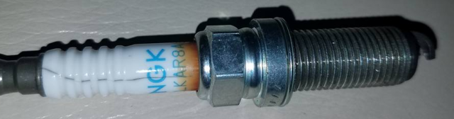

Some "cheap" plugs - their insulator can crack in two - in the ceramic casing - causing a open line to the outdoors from the center electrode to the side or nut/knurl of the plug. When the engine runs and if the insulator is compromised - the crack is now an air gap and the arc can easily shoot across - you'll see it as a "halo" or blue or cyan lightning color flashing as the plug attempts to fire,

Had several bout's with shops about Platinum plugs from Bosch - not getting shipped well, and arriving with chipped or cracked isolators ruining them - worse than buying a Heirloom glass vase from eBay and it getting smashed along the way - and you wind up with a box of broke shards - similar to this with spark plugs and cracks in their insulators.
