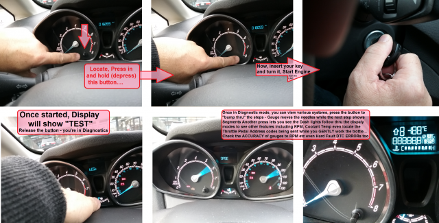

IF you can see if your 2011 Fiesta has a HEC - if it does then you can "monitor" several events and scroll thru some live data as you drive.
You just press and hold that button down on your Pods - as you start it - as you hold it, "test" will show up - then you've got it in the menu and you can just press that button and scroll thru over 20+ "functions" with many of them live data to help you determine the problems or if you need to see what the PCM is working with.
This display is about as close as you can get without having to go with a hand scanner tool - although the tool itself - if it's capable of it - can do a lot more than just "look"

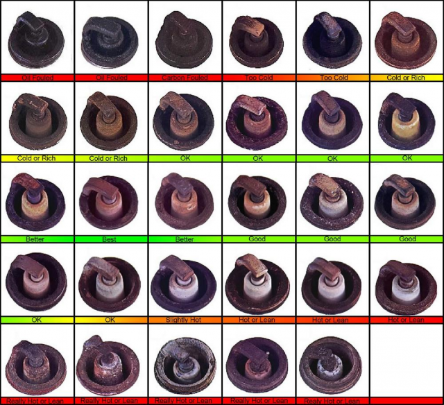

When you have oil consumption - check the spark plugs for soot and or oil on the tip.
Found this on the net...might be worth a look-see here...
There may be issues around those plugs. the above graphic represents a "Heat Range" chart and also shows the Oil fouling on the tip that I see from many owners that overfill their crankcase (Upper Left photos)
  • - oftentimes get to look like that because the oil gets pulled back into the combustion chamber from usually - two sources - the rings pumping the oil out of the crankcase thru splashing - and through the PCV valve, on; say a Fiesta, thru a "side port" off the block just under the cylinder head.
  • Oil from blow-by usually gets sucked back in thru the PCV valve and leaves an ash or white powdery crud from excessive gasses from the power stroke - that blows by the rings and poofs out into the crankcase. This stuff is the crud that has oil gas air mixed together and may even still be burning only to be quenched by the oil and lack of oxygen in the crankcase
    • These are fumes and can be re-burned even at the catalytic converter - gets caught up in the PCV purge vacuum or out the upper foul air pipe to the filter and snorkel, only to get pulled in the intake as part of the filtration process - this can also plug up your air filter itself from the oily soot if it's really bad.
  • - oil wet stuff means the oil level may be too high and the PCV sucks that oil in directly and fouls out those plugs from RAW oil (not diluted or fouled out oil "smoke")
  • So really, you have to look at the plugs to find out the "why" the mis-fire condition.

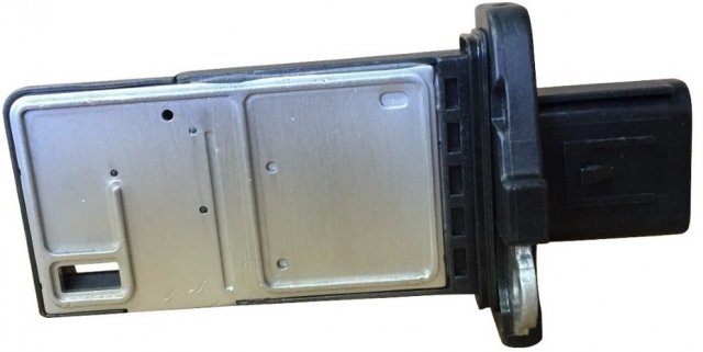

  • As @SyntheticAtmosphere eluded to, you may also have a plugged MAF/IMAPT sensor
    • - since yours is a 2011 - Intake Manifold Air Pressure Temperature IMAPT is not on it - it's actually on the manifold itself.
    • You have the MAF and is on the snorkel where the air filter is at. Just remove it and look it over closely.

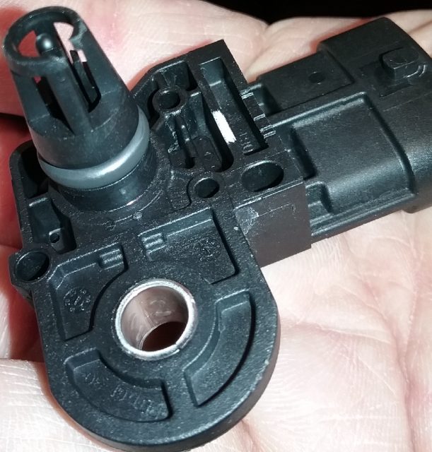

Or you may have the IMAPT sensor - located on the MANIFOLD itself between Cylinder 2 and 3.
Pay particular attention to the sensor tip...
  • The tip is two pieces - one is a THERMISTOR the other is a port over a pressure transducer
    • The Thermistor is a bulbous tip - that senses air and the temperature of it - compared to a known reference of a wire of known resistance at a specific temperature when subjected to a current applied thru it - when you place this in moving air, that tip cools off at a given rate - so that changes the current flowing thru that tip - that signal is amplified and sent to the ECM as a means to tell the system "How much" air is moving thru the system.
    • The pressure transducer looks at the pressure - it's vacuum, or less than sea level - like towards the upper atmosphere region - air is thinner (less pressure not as much air per volume the manifold is) so it does not need as much fuel to burn.
    • So it looks at the changes in the air flow - the greater the change, means the throttle should be opening up - so it looks at the Throttle position and your Accelerator Pedal Position sensor between the two it tries to figure out load on the engine using the MAF as part of the "Triad" to tell the system to inject more or less fuel into the cylinders.
    • You can look more at this here in this thread It's the second half of this TRIAD of sensors used to make the charge so the cylinder can fire. Your Foot, the Air Velocity going in and the Volume of air as a given pressure.
So if you can get under the hood, see what those plugs look like to help us help you figure out what to do.

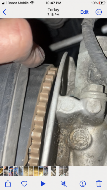

Today borrowed my neighbors code reader, cleared the codes, and took it to my friends smog shop. He scanned it and told me it had a permanent p0420 code so it won’t pass. To get rid of it I need to drive it so the computer deletes it. I’ve put about 120 miles on the car and it’s still there.
When I got home, my roommates friend from Arizona was in town and he is a mechanic. I told him about the problems I’m having with the car and he hooked up his scanner. It was one of those fancy ones with the hand held screen. 1st, he tried to turn in my fan and it wouldn’t work. We could hear the relay click when he tried to activate the fan but it didn’t turn in. 2nd, he pulled the codes and found p0054. The description was HO2S Heater Resistance. I think this is because of the spark plug non fouler but I’m not sure. It wasn’t there before. 3rd, regarding the “misfire” and shutting off. I couldn’t make it repeat what it was doing and he said he didn’t know why
said it’s probably a good idea to replace the timing belt if it’s never been replaced. I reached out to the old owner of the car to find out. I also pulled the cover the best I could to see the belt and it looked fine.
I took some time to look at the water pump. I didn’t see or feel any wet or what looked to be wet spots. I don’t think there’s anything wrong with it.
I also looked at fan. What I found was it didn’t spin freely. It was jammed with something. It kinda felt like a pine needle or something was stuck in there. It took a little force and it broke free. I kept spinning it both ways until it was free. I let the car run for a bit but it didn’t come on. Not sure it it just wasn’t hot enough or what. Now that I think about it, I should have used the live data on the scanner my neighbor let me use.

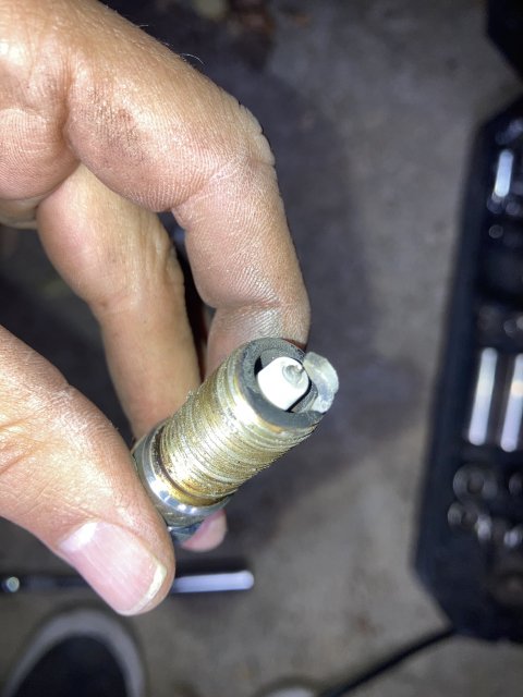

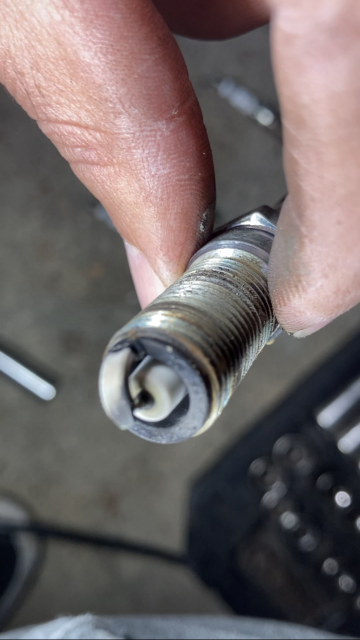

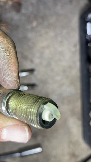

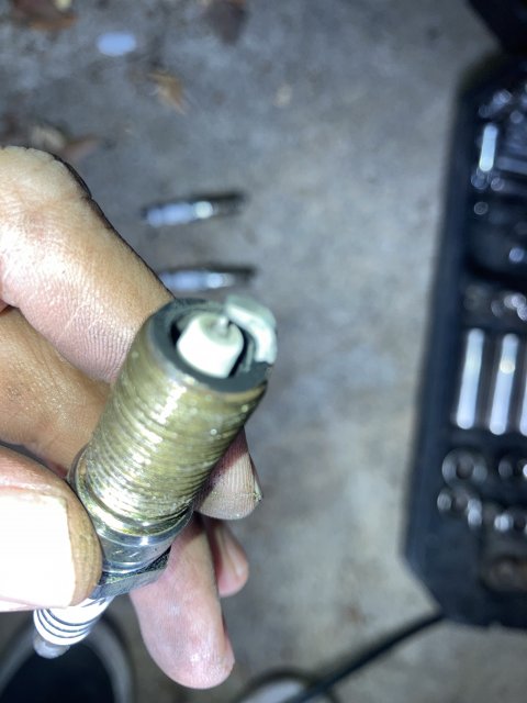

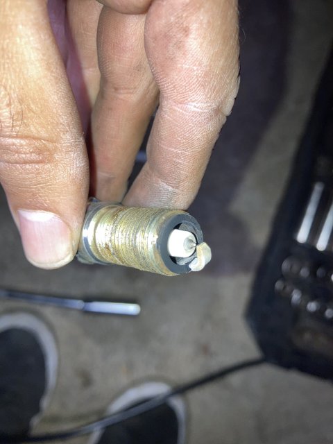

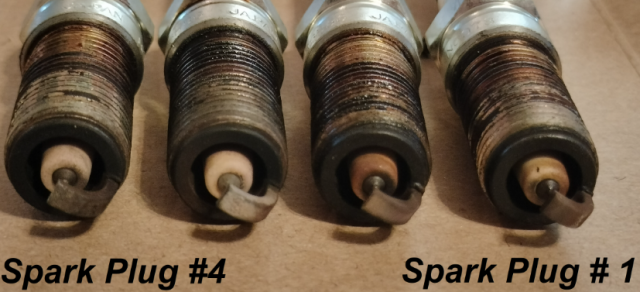

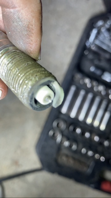

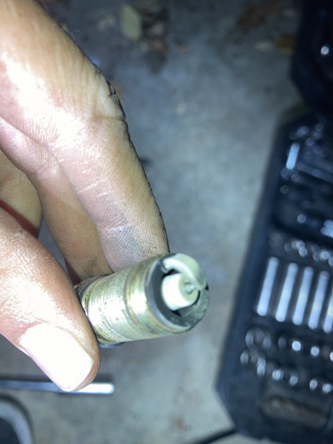

Results are in. Check out the spark plugs. Note, I post 2 pictures of each spark plug so there’s a better view of each one
Cylinder 1
Cylinder 2
Cylinder 3
Cylinder 4
They all look pretty much the same. I believe the white strap is high heat. The black soot around the circle part wasn’t thick by any means. What do you guys think?
Making another post for the compression test and MAF so I can fit all the photos.
