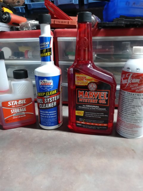

This image is the all the liquid additives i use.
The Lucas fuel system cleaner is awesome for soaking the gunk off of fuel injector tips. A mechanic friend of mine rigged up a plastic container that allows him to hang injectors "tip down" in the chemical and just soak.
The Marvel mystery oil is very versatile as a lubricant or decarbonizer. The Seafoam and Sta-Bil both seam to keep fuel from going bad equally well. My storage time span is around five and a half months. I cant speak to the efficacy of these chemicals for very long term storage. 20220510_191517.jpg
