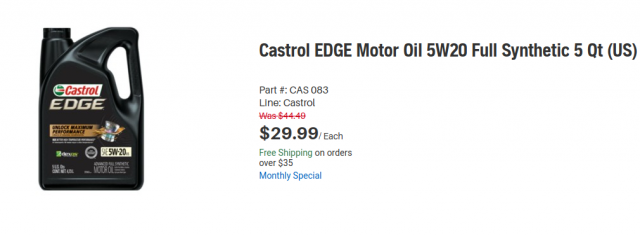

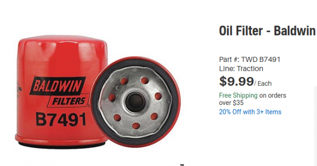

I used marvel mystery oil in the past and got a frozen engine to turn over. As for op question I just use Castrol EDGE® High Mileage 5W-20 Full Synthetic Motor Oil and Oil Filter - Baldwin Part #: TWD B7491. The problem with have 100 quarts of oil seating not being use is that the additives in the oil break down over time
