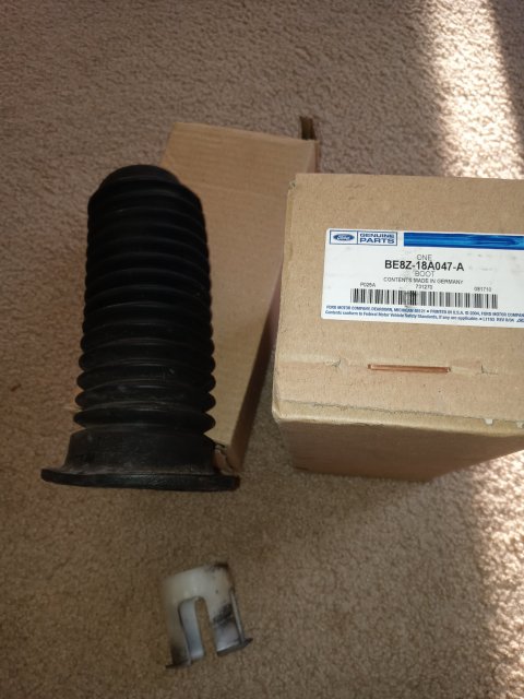

Hi Don. Welcome to the "other" forum! I am also struggling to get a few bits and pieces.
Don't throw away any useable shock or strut ancillary parts! This is becoming a replay of what I went through in late 2010 to get a decent suspension on my then new Fiesta!
I agree with you regarding the front bellows. The O.E. are the best version. 20210416_191112.jpg

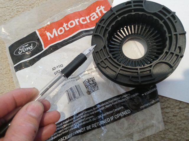

This is an interesting quandary. Being a fairly modest diameter of about four and one eighth inches diameter. Couldn't one just visit an industrial materials supply store and buy some nylon in the required diameter and mill a simple Spacer? It would need to have the reliefs for the top bracket # 3A197. Maybe require some sort of extension on the threaded end of the shock piston? IDK I am riffing. Never tried to increase ride height!
An interesting thing about the O.E. upper strut bearings! I just picked up a couple of new bearings from a dealership parts department. When i compared the new one to an unused new one from just a few years ago, i found a couple of changes. First change is the new one is a little bit "sloppier" when i rotate the upper part of the bearing. The second change is they have increased the amount of material and added four "ribs" on the outside edge of the smallest flange. I hope that the altered spec parts will last.
My pen pointing to the reliefs in the bearing obscure the view of the Motorcraft part number for the bearing. It is AD-1133. The Ford service part number is 8V5Z-18198-B. I have zero expectations of any further revised parts from Ford. 20210419_154633.jpg 20210419_160157.jpg

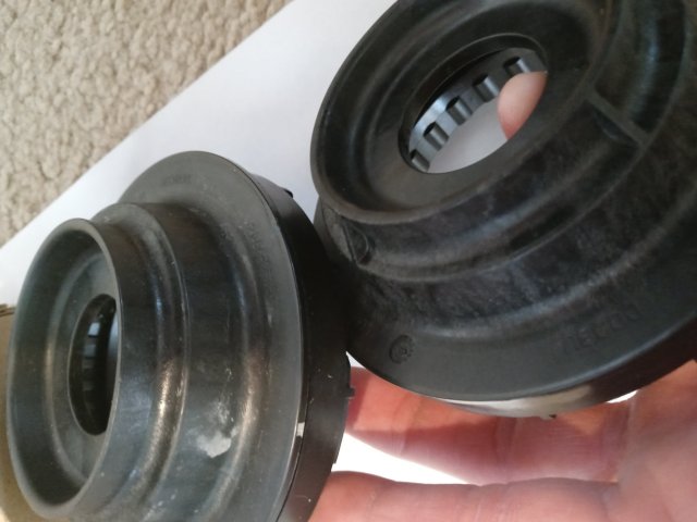

Andy is dead-on regarding the indentations. For those that aren't sure what we're referring to:
For the sake of comparison, here's the OEM top set and the KYB top set side-by-side. Ford OEM with the silver mount plate is on the left. KYB with the black mount plate on the right.
You can see the small additional ribs around the bottom circumference that scotman is referring to.
I took another shot at a slightly different angle to better show the vertical ribs on the inside diameter of the OEM bearing. I don't know what degree of structural benefit it offers, but it does center the mount more accurately. The KYB has noticeably more lateral play when you move the mount across the top of the bearing.
Let me know if there are any measurements or further photos that might help move this thread along.

Scotman, are you building up a set of struts in the near future? I'd be interested to see if you experience the same behavior with the top mount/bearing that I'm seeing.

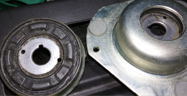

Andy, can you please describe this puck and hole further? I'm trying to place it and my noggin isn't firing on all four today. I've had a rattle/clunk for a long time now, and after two shops shrugged their shoulders, I chalked it up to cheap, worn OEM struts. At 96K miles now, new dampers are certainly not going to go to waste, but it makes me wonder if this is the source of some front end noise that I've had for a long time.

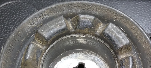

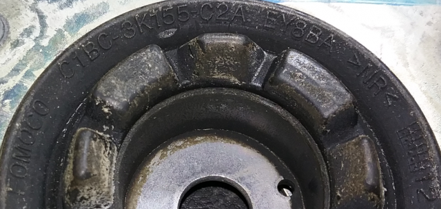

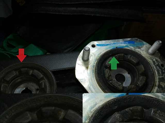

Well, I'd have to take the car apart to do this...
Hmmm...can you settle for say, a picture of the puck? The Strut mount itself is in the car now currently acting as a spacer - I'm working on some ideas to reuse the old strut mounts that lose their pucks...It's a sad story but I hope to find a happy ending to this - someday...
Green arrow points to Puck number - both being the same - but Green identifies the mounted one.
No, seriously - I did say that - yes...
There's not much to these bushings - the polyurethane and rubber - but the polyurethane seats to the mounts metal base - there is no adhesive - as you can see by the one on the left - simply popped out...
The mounted one, refers to the link (earlier) to the "ST" one - these bushings - that number simply is the bushing...
The empty cup, the thing (puck) is held in, is being used on one side at this time for a durability / survivability test and as a spacer - look at the raw pics of the puck itself and the cup / puck assembled is the best I can do at the moment.
The way I even found this out was by shining a light into the strut tower hole and bouncing the car - it is then I noticed the post of the rod and the nut - and the puck all together moved as one unit when the car was bounced.
When you lift the wheel up to remove the tire to get at the strut, the spring tends to want to reseat the puck - but it can be easily "bounced" loose again by "bouncing" the strut / spring assembly - you can then see how that puck moves with the rod.
Loosen and remove the nut, the puck easily pops out with little effort - for the spring doesn't have enough tension to reseat it - once popped loose - the puck just rattles and bounces - in some road potholes, that rattle can be a bit upsetting to hear it hit the top of the inside of that tower.

#40
That explains it nicely, thank you, Andy. I couldn't imagine otherwise that they'd separate from the steel plate. Damn.
