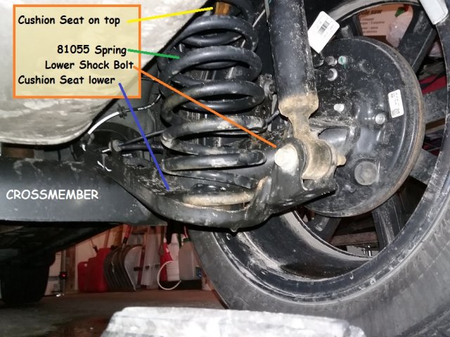

As far as the Springs go, the OEM ones are quite short and as you lift the rear up - you'll see how they are placed and seat. They are considerably shorter than what I was surprised to see and did not need to use any type of coil spring compressor to remove them. It (steps to do this) was to loosen wheel nuts, Remove Rear Shock Absorber bolt from the Crossmember - Wheel chock the front tires - lift rear cross member - remove wheels - take a SECOND jack and lift entire rear to allow cross member jack down - springs fall out - that simple - didn't have to be concerned with the brake lines - they will still be curved enough with hose line length to allow the hubs to rest smack on the pavement. The spring base in the crossmember pretty much handed the spring right to you.
New springs were stiffer as well as longer so the ride height is better for rougher terrain and roads that would have taken an ST for a wet piece of paper and pretty much shredded the undercarriage.
I used per website above - Monroe 81055 - below is what you have in the OEM Ford you have now...
They've been replaced by the 81055's - note the taper winds and the "banding" - it identifies that is their top - the bottom side that seats in the crossmember housing is on the bottom - the box the 81055's came in is what Iv'e stored these in case I need to revert back - if ever - not likely but - then you never know...

Now as far as "stiffeners" for anti-sway goes, there are at least two I've seen and I've settled on the ones that "bolt" to the shock spring/Absorber base and stiffen that rear crossmember. This is a Hatchback, not a Sedan. So in one way, you gain trunk space and a 5-th door with a hatch, but the Sedan offers a little better sway and twist integrity unto itself by design for hauling but is not as "sporty" if you needed to make this work yet have something fun to drive. The sways' were added after the initial hauling effort, and I didn't really feel the need for them except for the ability to handle rougher roads having the sway bars. A punishing ride either way, but I feel there's more to keeping the car aligned for a longer period of time in between it's service-life intervals.
So they've been removed for now, for they are not needed except for heavy-heavy hauling which I don't think this car will ever do - but I'm keeping the swaybar just in case...
