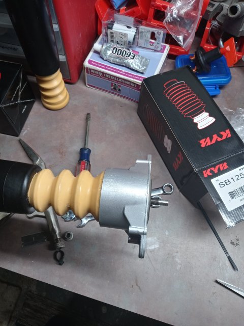

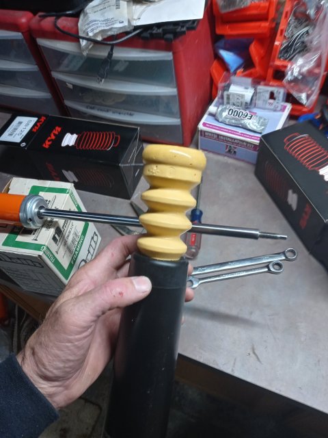

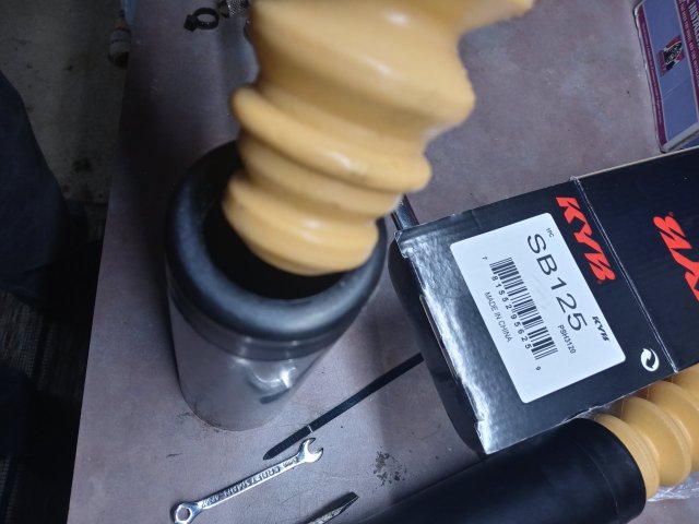

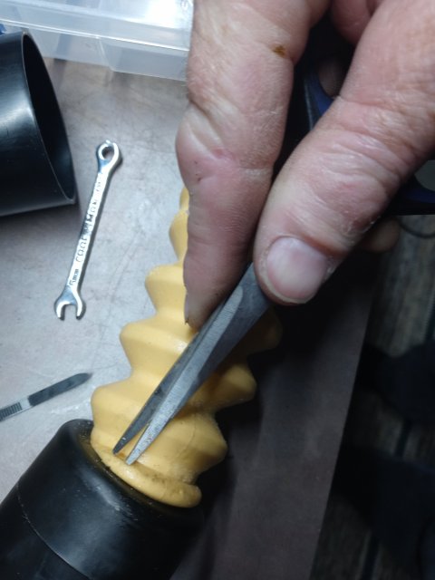

I received the rear shock bellows kits this afternoon. KYB. #SB125. They require some assembly involving pressing the foam bumper into the top of the cylinder that protects the piston from debris. I found that a small pair of scissors worked better than a screwdriver or knife.
Once assembled, these are a perfect dimensional match to the O.E. bellows that cannot be aquired over the dealer parts counter.

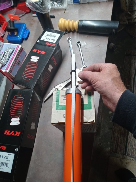

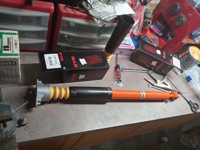

A vise is nice. But not critical to the assembly of the few bits onto the piston. Once you remove the retainer strap the shock piston will extend itself.
In the second image the bellows is slid onto the piston and the mount is pressed onto the foam bumper. It takes a bit of squeezing to seat it fully.

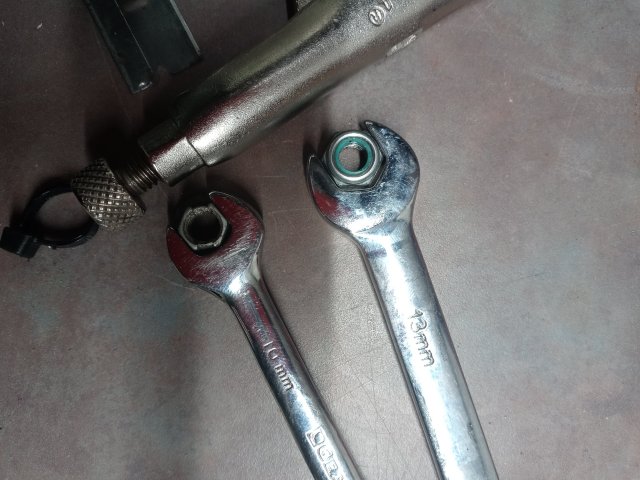

Koni supplies a new, 13 m nyloc nut. The thread size and pitch is the same, koni just gives us a meatier nut than the 10 m nut Ford shocks got. And the next image is the completed shock.
Front struts next.
20210421_214649_HDR.jpg 20210421_215736_HDR.jpg 20210421_214813.jpg 20210421_233408_HDR.jpg
I have the KYB bumper and shroud as well. I should have taken better photos earlier, sorry. What I'd found is that there's that angled cut or divot in the inner diameter of the opening of the plastic shroud that if you start pressing the bumper in at the right angle, you can twist the bottom of the bumper into the lip at the top of the shroud. It's like it screws or threads in. I also used the KYB upper mount. Like you, I found it takes some working to get the bumper seated in the mount but it does fit well and nicely tight. Given what I've seen of the KYB parts, they did a very good job with this set.

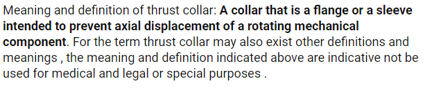

Thrust Collar?
Excellent!
I'll get more about this approach. As I learn more, I'll keep you posted.
This wording may have some answers as to what I'm looking for.
Although "Thrust Collar" in appearance, may not look right in being applied, in principle, it is. Bearing? Again, this can be applied but in either case, this simple cup provides several resources to handle the jarring of everyday life. It's simply absorbing, transferring the vertical motions to the cup, the Strut itself works to counteract the torque using friction to dampen the motion - the axial twist is thru the cup to allow the strut to only handle the vertical axis motions - the side to side or rotational torque can also occur thru steering - hence the "bump steer" effect experienced by an experienced user learning the performance curves of the vehicles driveline and powertrain.
This just helps me go in a direction to look for other methods and answers - Be sure to Tell them that we really appreciate their help in this.

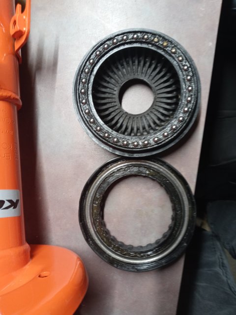

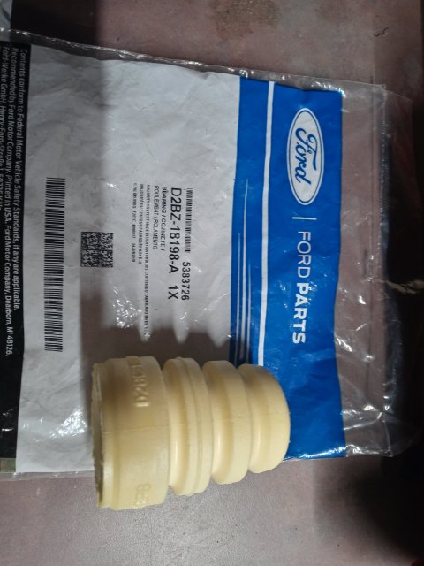

Why I am going to continue to call it a bearing.
Ford has decided to deem this upper bump stop to be a bearing because they changed the part number. I guess that they can call a sewer rat a sirloin steak. but, that isn't going to motivate me to eat it. 20210423_190631.jpg 20210423_191655_HDR.jpg

Is that one of your old strut bearings, the earlier style/part number? I don't think they're supposed to come apart like that, are they? :LOL:
Thread Starter #50
That one is a old style used version. I just carefully popped it apart. It went right back together.

That strut bearing design reminds me of a much, much larger bearing assembly design that I've done testing work on. Is that a metal ring on the top half or shiny worn plastic? Thanks for posting that, interesting to see what's actually in there. (y)
Thread Starter #52
The BB's ride on metal races.

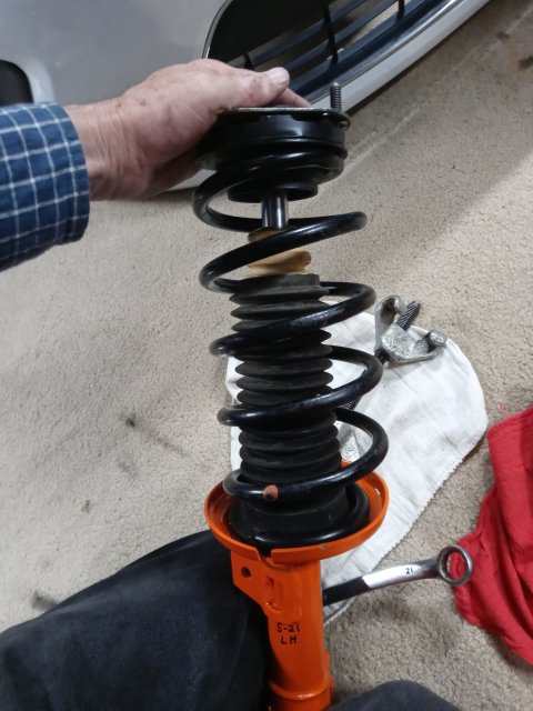

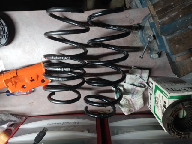

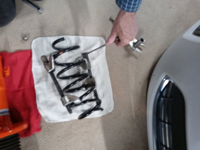

Here is a stock front coil alongside the (non Supersport) H&R front coil. I will dust off my spring compressor and install a used, early version bearing and then i will try a new improved one and compare them, after dinner. 20210424_155008.jpg It's too rainy to get anything done in the yard. I will satisfy my curious mind, instead.... And probably drink a beer or two.. This is for science dammit!
Thread Starter #54
Ok. My impression of the new versus the original upper bearing is that the new version has slightly less resistance to rotation than the original version. But I'm going to say that the difference is about 4 lbs or less of resistance.
I can turn the top mount with one hand while holding the strut pinched between my knees. 20210425_201809.jpg

The short spring setup is a little bit easier, yes. I wonder if that is partly why so many of the bearings split. Little preload then huge, sudden crushing impact?
I didnt put the bellows retainer ring on it and i inverted the bellows. I didn't think that would matter. That spring is under a lot of tension. When i use the short spring, that soft lip on the bellows helps cushion out some of the looseness
