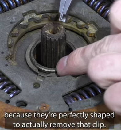

snap-on SRP2B is similar to the one I have. The one in the video has an angle milled into it so it fits the angle of the circlip end. See 1:49. S3e picture I added. tool02.png
