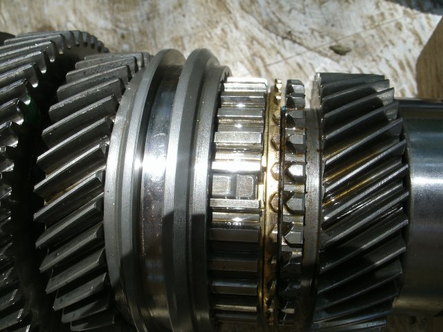

I took the transmission apart. Very clean. Very little filings on the magnet. Just about no wear on the parts. Bearings feel good. I noticed that when I moved the 1st/2nd synchro assy back and forth that one of those 3 rectangular pieces (dogs?) did not always move along with the other 2.

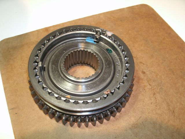

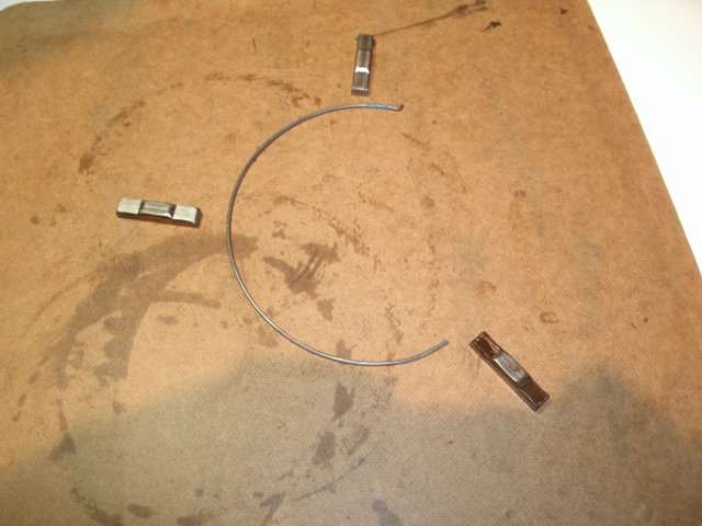

I took apart the main shaft assy. I then took apart the 1st/2nd synchro assy. See picture. Those 3 pieces reside inside the synchro hub and are held in place by a semicircular spring on either side. I don't know how to assess how good those springs are.

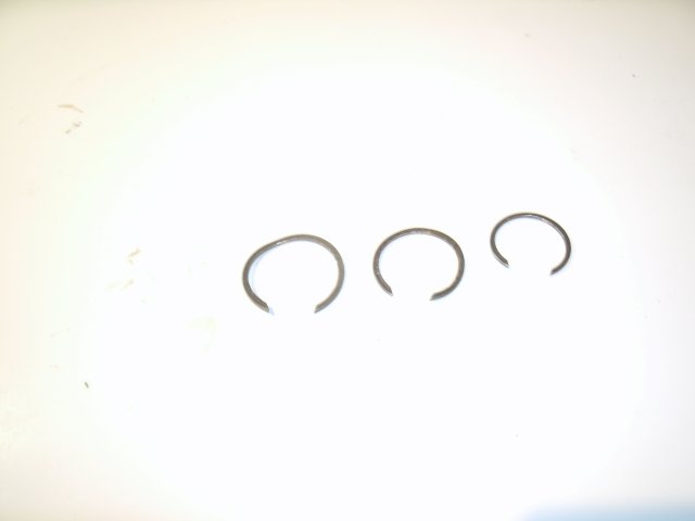

I had a lot of fun getting the 3 circlips off of the main shaft. Is there a source for new ones? GEDC2585.JPG GEDC2616.JPG GEDC2617.JPG

Try this FoMoCo String...
FoMoCo 7s6r-7c115-aa
In your search engine, you'll come up with the 1-2 syncro - but to find a rebuild kit? Not sure...I get some hits but you'll need to take it from here...

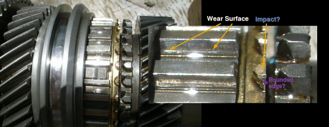

So you know, the teeth do show some considerable wear on the face - and the brass of the syncro gearing took most of the beating and since it was soft, shows the blunting of their edges - so the tranny needs some service but not sure what kind of wear abuse this was - if it came straight from the factory this way or did someone get cute with it and used a far thinner fluid like Dextron LV? Light loads it's - not a bad idea but this is a manual and uses the gearset to move oil to press into the surfaces.

Ordered the synchro unit from a Ford dealer. It is an updated one for my car. I am now on the hunt for the 3 circlips ford P/N E860141S (HR2), E860146S (HR3), and E860303S100 (HR4). forget ford terminology for them. Clips.JPG

I don't think there is considerable wear. If there was, where's the filings?
Its not what you look for in filings, it is also in assembly...
The Ring that the syncro uses to mesh with the teeth was lifted, you don't find filings - more like bits of metal by the or in the magnet by the trans-axle side.
The battering is brass so the magnet wont catch it. You even have rust in there.
This can deform the ring so it "torques off" every time you apply power.

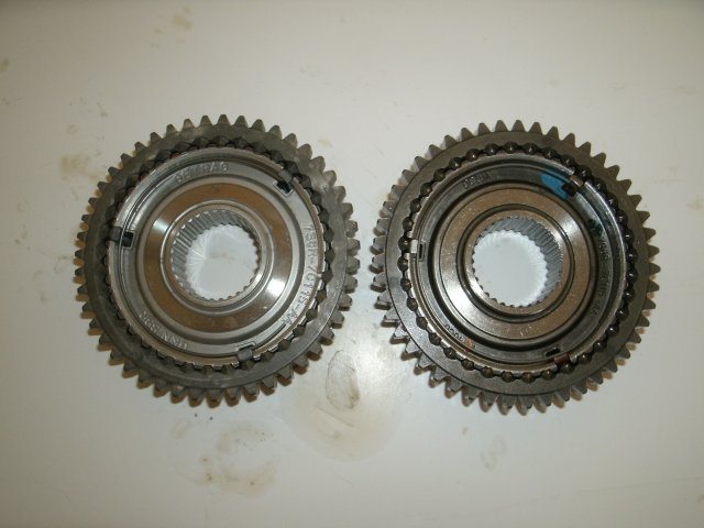

New assy is on the left, GETRAG. Old one on right is FoMoCo.
1st gear outer synchro ring that you noticed wear replacement has been delivered. Was waiting for one more delivery of the smallest retainer ring, snap ring or what ever it is called. Decided at the last moment to also order the "Ring" and "Inner synchronizer Ring" just to be safe. Also the rear cover gasket. See https://www.fordpartsgiant.com/page...ronizer Ring&pdUrl=synchronizer_ringWondering what sealant to use when I join the 2 transmission case halves together. I know have seen a Ford sealant for that but no can find.

I replaced the 1st/2nd Motorcraft synchro unit with a Getrag brand one. No problem downshifting into 1st now.

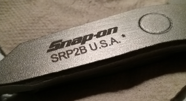

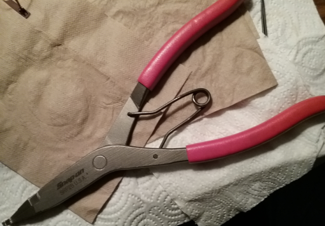

. At about 1:44 he uses a circlip removal tool. Looks like it is made specifically for the circlips ford uses. Similar to the ones in their Fiesta 5 speed manual transmissions. Never seen any for sale like that. The ones you can usually get at stores or online just kind of work. I was finally able to remove circlips from my 5 speed using the regular circlip tool. That got the clip to spread just enough that I could attach a miniature vice grip to the opposite side and pull it out with out destroying the clip.
He also uses a bung to plug into the output shaft holes so you don't spill fluid moving the transmission around when removing it from the car. Is there a source for them?
Anybody know a source for that circip plier and those bungs?

Don't know about those bungs but Snap-On Tools offers those pliers...
For better resolution - see the attachments on post #37
