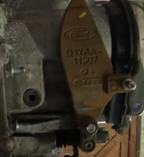

There have been some videos, and I remember coming across a blog about how someone took apart and B5 earlier version and found out how the end caps retained the bearings - so your issue with the OEM transmission may fit this profile especially if the larger shifter lever in the front cover box on the tranny is the larger wedge shape and it's pivot point was nothing more than a smooth stud and the bushing on the lever was all it had to cushion and move against this metal stud.
Here's an example...
What I'm trying to help here with is to establish a build date or year so you can see how the iB5 evolved into what it is now. Many of the older mechanical ways of making this work were built on the smoothness of the shifter and overcoming some obstacles of needed redundancy - as in the shift forks work the ring gear onto a cone that then forces another gear to move as the syncro presses teeth into the splines and it slides onto the gear as a single unit once all the teeth are meshed and aligned so the fork slides it over onto the gear next to it.
Because? The newer gears and their support are not always backwards compatible with the older rebuild or case designs.
I get what you're telling me. That piece in the picture moves smoothly. No slop. All those external linkage parts move nicely.

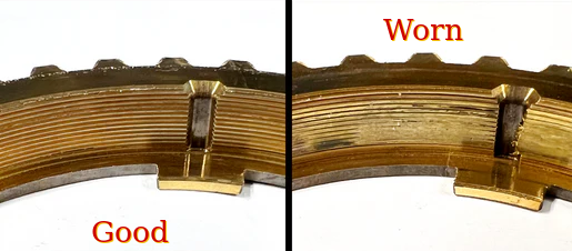

I don't think there is considerable wear. If there was, where's the filings?
Its not what you look for in filings, it is also in assembly...
The Ring that the syncro uses to mesh with the teeth was lifted, you don't find filings - more like bits of metal by the or in the magnet by the trans-axle side.
The battering is brass so the magnet wont catch it. You even have rust in there.
This can deform the ring so it "torques off" every time you apply power.

New assy is on the left, GETRAG. Old one on right is FoMoCo.
1st gear outer synchro ring that you noticed wear replacement has been delivered. Was waiting for one more delivery of the smallest retainer ring, snap ring or what ever it is called. Decided at the last moment to also order the "Ring" and "Inner synchronizer Ring" just to be safe. Also the rear cover gasket. See https://www.fordpartsgiant.com/page...ronizer Ring&pdUrl=synchronizer_ringWondering what sealant to use when I join the 2 transmission case halves together. I know have seen a Ford sealant for that but no can find.
