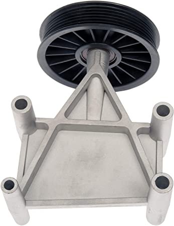

Got an old Ford Focus laying around? It has a tensioner dummy pulley you can possibly fit in it.
Where? Just open the hood and look to the Left...
1,902
There was a thread here that discusses the A/C compressor delete done on B spec Fiesta race cars. There is a cast aluminum bracket with a dummy pulley that replicates the compressor position and pulley diameter exactly, minus the weight and drag, of course.
I would suggest that you install a new serpentine belt of the original size if you choose to go in this direction, reused belts tend to be either noisemakers or jump off the pulleys.
<<<Thanks - put if I pull the fuse for the AC, then the clutch will never be triggered by accident and the external fly wheel would just spin freely?>>>

Length of time? Enough to lubricate the seals - it Has to run for at least one minute - even then the lifetime is still finite - so with the compressor costing so much in Australian currency - it may be better to try and use a rebuilt unit or run with a AC delete "dummy" roller as @scotman mentions.
You can disconnect the fuse, but the bearing will eventually run dry - so don't overlook this...
It’s Dorman #34298
