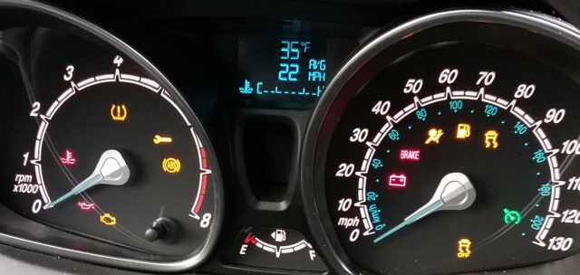

Hey guys so my ford fiesta wasn't showing any bars on the temperature gauge, then when i turned the car off and back on i noticed it struggled a little to start. After that the battery was completely drained and would not start. I tried charging the battery at AutoZone only for it to start a few times with the temp gauge working and then go back to being completely dead.
Has anyone else had this issue? The only other problem I have with the car is that it struggles to start after pumping gas, but always turns on after the second crank. Could these problems be connected somehow? Any help is greatly appreciated.
Basically sounds like your battery is shot. These cars are super sensitive to low voltage and low amps. Try cleaning all the grounds around the battery. Did AutoZone load-test the battery?
The starting issue after pumping gas is usually related to the EVAP system and/or sensor. Mine used to stumble a bit after I filled up, but if I stopped doing any top off--when it stops, I pull the hose---no topping at all; that stopped the issue.
What does your console tell you?
(Not to sound stupid but...)
Your Dashboard, if not all the SENSORS are connecting - they don't always light up - the circuit to them is OPEN, just as bad as a dead short - at least with a short, you see the light left on in the console for the circuit it affects ..
When they are OPEN, does not mean it still communicates and then says "hey wait a minute" - no they are OFF - and stay OFF - does your "key to ON before starting look like this?"
Some will wink out after a moment (self test) yes, but some will ALWAYS BE ON until the Engine is started.
