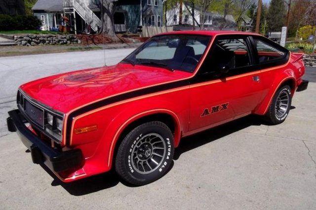

I didn't realize that they were offered with a v8 until very late in the 1970's when the older brother of one of the guys i went to school with bought a new 1979 Spirit amx. It had a 304 in it. I had never seen a v8 Gremlin! These are truly rare. 1979AMCAMX_01_700-1.jpg

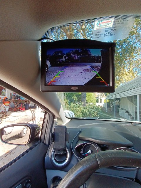

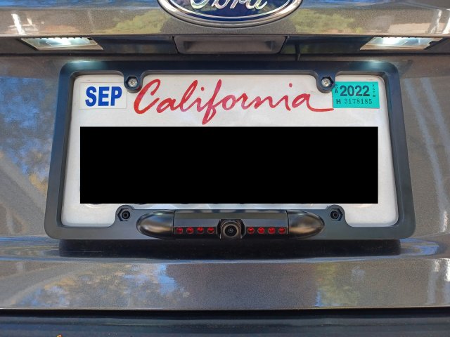

I friend gifted me a back-up camera, so I installed it today...4 hours. Now I see why folks buy the Bluetooth models...the wired ones take forever. Works fine.
Thread Starter #127
That's a pretty big monitor
Yeah the wide-angle makes it look huge! It's just 3-inches diagonal. That Speedee sticker is barely 2-inches wide. Made my friend say the same thing when I texted it to him.

Well, considering perspective, that being right "in your face"
You could have a simple little "Ghost spider" crawling up your nose - you'd think it's a giant tarantula climbing a banana wanting a piece of you...

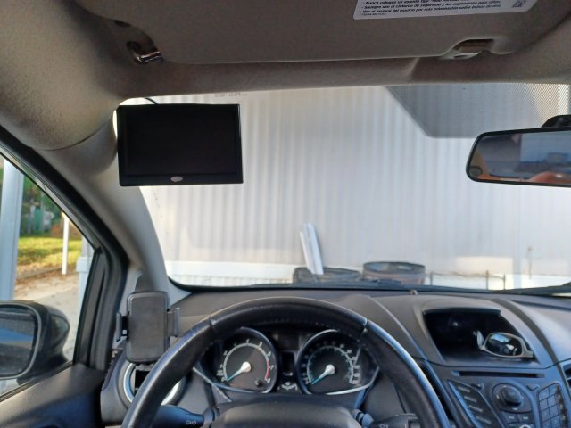

It sits a lot closer to the windscreen than it appears, too. I can still lower the visor down and past center toward the window quite a ways. Pretty happy with it so far. Roughly how I see from the pilot's seat...

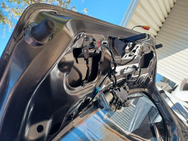

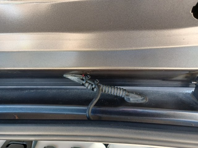

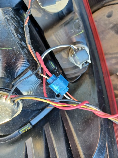

It was quite tedious getting the power cable from the plate to the right reverse lamp hot wire. It wasn't hard, just a lot of fiddling and creativity to get it through the hatch and down to the wire. The RCA cable was a real pain because the connection is so big. I gave up and ended up cutting it off to guide it through the hatch, and then once it was all the way to the dash I reattached the end. Once I was in the cabin it was easy. I pulled it through the left rear rubber wire tube between the hatch and cabin, and tucked it into the left side of the headliner all the way forward, down the A pillar, and was done; like 5 minutes to do that. I connected the ground to the master ground just behind the OBD2 connector and found an always hot red wire to splice into near the ground. I strongly advise doing a "bench test on everything before you do all the work. I hooked up everything to be sure it all worked, as I knew it was going to be a lot of work and didn't want to invest a bunch of time to have the screen suck or not work or have the camera not work. I did have to flip the camera 180degrees because it covered the hatch latch. I was surprised when I hooked it all up and everything was upside down on screen! I just flipped the cameras in the plate and was done.

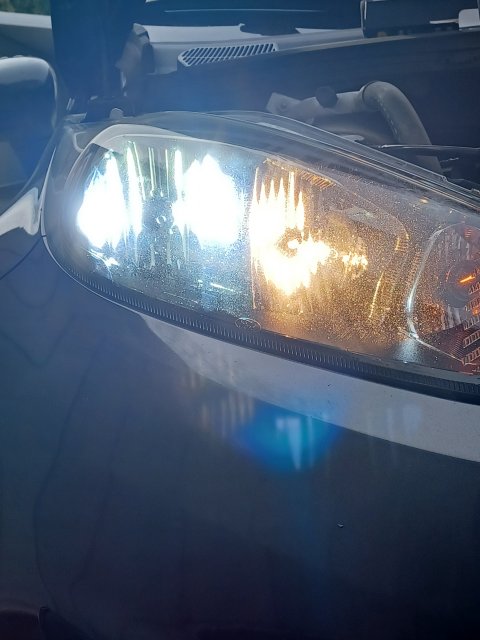

Sent back a set of TechMax H1 bulbs...did not fit in the socket. Ordered some regular Philips H1 halogens that I know will fit...and they should be ass-hat bright. I am driving to Denver over the holidays and a lot will be at night...I hate no being able to see.

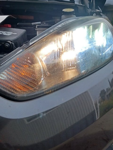

Can't really tell the difference by looking at them, camera can't show it accurately. I have a long trip coming up so I can report back later. New tires this week, too. Rears are on the wearbars; not good for traveling in rain and/or snow.
Old high beam, then new....

So far not crazy about the new high beams....it's been raining hard so, again, hard to judge. Should see some really dark freeway miles in Utah Satuday night. Test to continue....

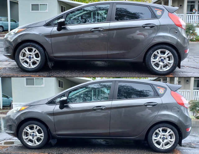

New shoes...feels sturdier. I think the shoes that were on it were factory (6 years old & 75k miles). I like how they fill the wheel wells a bit more. They pooch out a bit more from the added width, too...yeah that is my style. Road trip test in 2 days.
New ones on top:
