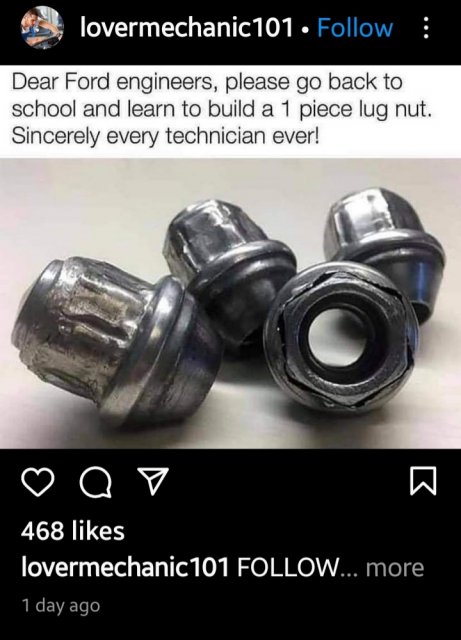

Only got to the lug nuts, today. Nothing else came in the mail, except the air filter...gotta wait 'til the filter oil shows up on Monday.
Man, I am so glad I did this. The stock nut caps were still on the left front wheel nuts and they would not come off. I had to beat them off with a hammer and a punch. What should have taken 5 minutes took 30 on that wheel. What a nightmare these things are. What were they thinking? I imagine my daughter trying to change a tire in the middle of the night battling these stupid caps. Caps...now trashed! Gotta dress up the tires to match the shiny new nuts!
View attachment 4365 View attachment 4366
Saw this on Instagram....oh how I hate when stupidity gets into production.

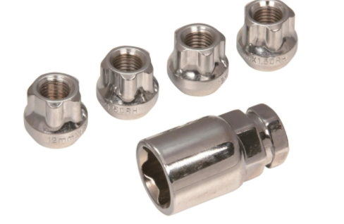

Ranks right up there with the one lug nut that has to have a "key"
Cruze as well as many others used a "speschul chuck-chock key" - and for that-many an owner left their vehicles on the side of the road because they couldn't figure out how to take off, let alone put on, their spare tire...
Had to help someone take off their tire. It had one of the above. To remove it - used a pair of Vise-grips to "torque" off the nut and sub in a new "regular" one.
  • These are simple "anti-theft" types that were "keyed" to the vehicle VIN and were dozens of combinations used during their assembly line days
  • Can't just go in and get one from a dealer, AutoZone laughs - O'Rileys offer Dumb Looks (Which are still free) - and since these are specific to a type of year or model - you have to special order one through the dealer as a replacement "chuck key" about $75 in 2019 dollars...2 week wait for that now.
He had more, each wheel had one. A good spare in the trunk but empty glove box and no tire wrench either.
I left it with that and just changed the tire - he had no clue where the "key" was.
  • - so be aware of those whom buy used from a private or unscrupulous dealer - you might get stuck on the side of road from the loss of this special chuck key to remove that last lug nut.

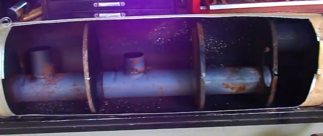

The above is a cutaway of a Ford Exhaust muffler for a F150.​
  • Ok, many would ask, "You know...that is not on the Fiesta..."
  • No, it's not, but is to prove a point.
  • Note the use of chambers and the main inlet tube is using two with each one a branch Tee - note the lengths of the Tee and the location of the main Port is one of the last before the final one that is the tailpipe - using the effects of wave cancellation because of the backpressure the system has in this area - slows down the puffs, this is pretty much the what Ford applies to all their Muffler systems.
  • Also, they do not use Fiberglass - it just doesn't last as long or is as durable.

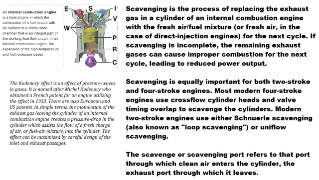

  • In reality - it's not. Many other sites have proven that a small level of backpressure in the system helps with Low-End Torque. Like Here and even over here...
  • An effect called "scavenging" can ruin the ability to use the leftover unburned exhaust fumes from the combustion to offer a bed of added fertilizer to make the next stroke more productive.
    • Yes, I said that, because of an event with Valve timing and the slower release of the exhaust on low RPM moments. You can change the valve timing to allow the exhaust and intake to either overlap, or not - to allow the vacuum in the pipes and cylinder - to enhance the intake of fresh charge and to remove the exhaust - but utilize the vacuum present - to remove and displace - what is left in the cylinder.
    • Ok, I remember a thread or maybe two about how motors evolved thru the years and now Sigma, Ford's latest, is a 4 port system - 2 intake - 2 exhaust, while other earlier versions used one intake (albeit very large port) and two exhaust.
