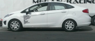

1666298232970.png .

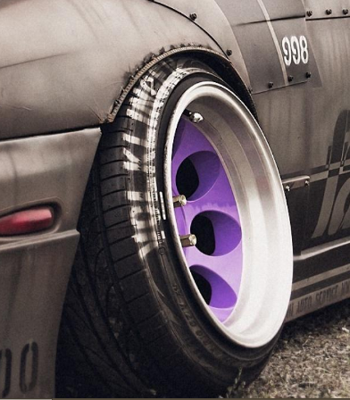

Or maybe some wheels like these oz's
I'd like to get white wheels similar to these. I think those are 17's though.

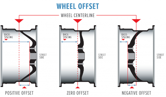

See how far in that wheel - tire and all? (The Wheel rim the outer show piece or design, the spokes that bear the weight and then the inside flange) - see how that recessed area - is?
  • That is the OFFSET how far the tire is brought into (Back Spacing or Positive offset) or from (Negative offset) the center line of the wheel is mounted the hub and the steering knuckle and wheel bearing. - being bolted to the hub with the steering knuckle and that CV joint going to the transmission - see where the contact point is, and how nearly "in-line" with the Strut and at a height for the control arm to pivot up and down and not strike the pavement nor does the wheel strike or rub against the fender or the fender well.
  • Some instances of SAE versus Metric and ISO - most offsets are now expressed in mm (Metric) while other Rims might be expressed as inches or fractions of inches in offset at a 1/100th in Decimal - an older standard based upon SAE.
IT's a pretty tight balance in there as a STOCK form of the Fiesta is.
When you make changes, where all that suspension sits, is going to be affected too.
The reason why Ford Chose these sets of sizes and nothing more or less, was really due to safety - for the passengers and the car to stay on the road. They chose a wide 6" X 15 with a 42mm Offset for the Rim size for the Fiesta to help with stability with makes the vehicle safer for more conditions that the driver will face than many realize.
The Offset is a Minor - but plays a big role in how the tire tilts and rides on a turn radius to make the car steer.
Offset is designed to let the tire and wheel work as close to the centerline of that "axis" that strut rotates using the Tie rod and that lower control arm to work against.
When you change Rim Size, you affect how much room you have to steer the car with that tire in there not bumping or rubbing against something - shortening the tire and the fender wells, life.
Change Rim size, means you'll have to find an Offset that helps you maintain aspect of Axis - or turn - and have the tire steer you without you having to fight the effort - just to make a simple turn.

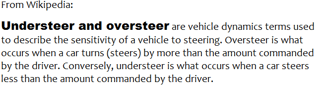

This is where Oversteer and Understeer start to play a bigger role.
Camber Thrust (Bump steer can be thought of as this) is another - and gets MAGNIFIED in force when you go wider tire and even lower the cars' clearance - because there is less room for rebound for the strut to work with. It's stiffer ride and lower height may make you look cool - but the lack of clearance and uneven road pavement can make a simple work commute, the biggest chore of the day - just to get home.

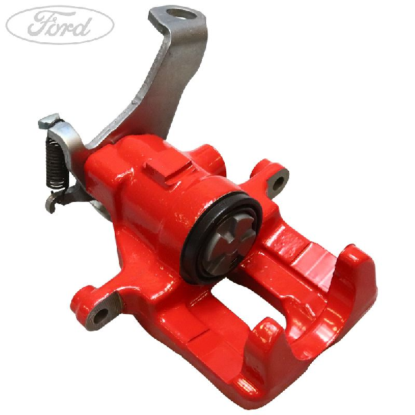

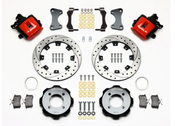

Although this may have been touched on in other threads, the suspension is not the only thing "reworked" on an ST versus the everyday common Fiesta - they redid some braking as well.
ST's use Rear Disc brakes and some upgrade kits require some extra rework to install the rear drum pads that are used when you apply the parking brake - although this may sound silly - the ST does have a rear parking brake as a cam that moves the calipers "fixed" sides (squeezes) towards the rotor - effectively parking (applying) the pad to keep the vehicle from rolling when the parking brake is applied.
IN a refit kit- unless you wish to replace the calipers with the FORD ST OEM ones - the kits usually keep the cable and put in smaller pads that rub on the inside of the rotors section that take the recessed portion of the rotor to the raised part that meets the hub.
Kits like the ones shown above tend to try and keep the OEM hardware and functionality of the original brake hardware and support intact as much as possible to reduce the retrofitting cost in labor and parts (a considerable effort) so the kits to me, are a luxury I don't want to mess with - but for those that do - they are out there.

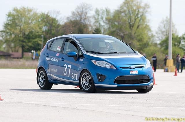

D30C8386-5CB5-495C-9FF1-2B3F21D8B5AC.jpeg Ok.
My autocross setup in 2012 was as follows.
Eibach Sportline or H&R super sport springs.
White line polymer control arm and rear axle beam bushings.
FR3 struts and rear shocks/ later developmental Koni Sports.
Eibach rear anti sway bar (internal type)
High durometer poly bushings for the stock front anti sway bar mounting points on the subframe and Powergrid adjustable end links.
Side locks on the sway bar at the outside of each bushing mount (to minimize the amount “side slip” or lateral movement as the sway bar did it’s thing)
One set of camber bolts for the front struts. Basically they are eccentric bolts that let me get a couple degrees of negative camber at the knuckle without the use of camber plates, which weren’t allowed in STF.
15x7 OZ Ultraleggera lightweight wheels.
205/50HR-15 Dunlop direzza star spec tires shaved to about half of full tread depth.
Additionally, my preparation included folding rear seat backs down, draining the washer fluid reservoir and relocation of the battery to the right rear corner. Measured fuel loads. Remove the spare tire and Jack equipment.
Remove all floor mats. Remove Big gulp from console cup holder. Find a place to pee before your run group goes out.
There were some other things I did. That were specific to the traction control and stability system issues that were interfering with going around corners quickly. They don’t apply to newer Fiesta’s. Sorry for the late reply. I had to go look through my notes from the build.
The changes I made resulted in a very firm but tossable Fiesta! Like a go cart. Too bad the stock gearing was fuel economy oriented. Specifically the huge chasm between second and third gears. If I could have changed third gear it would have been a much better “large course”car.
