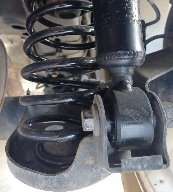

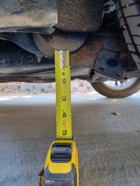

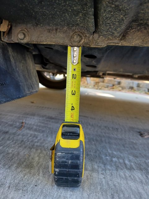

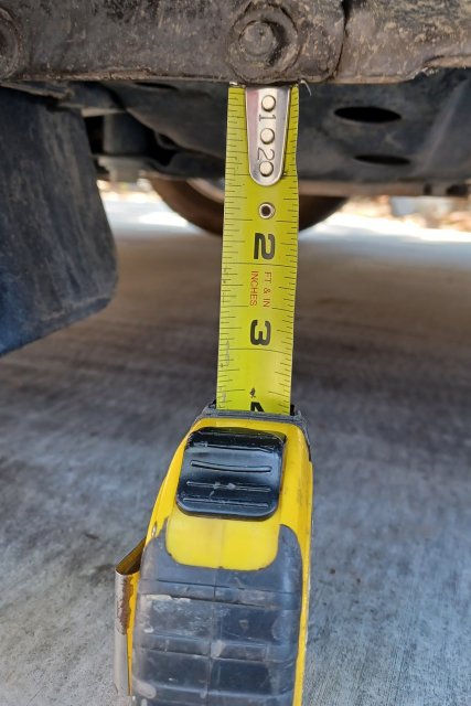

Next Tuesday gonna get KYBs installed front & rear with new Ford FR3 springs, roll bar links & bushings. Stay tuned. Front & rear ride height for reference...7.5 & 8 inches respectively; not quite level ground, but a good consistent surface.
Thread Starter #209

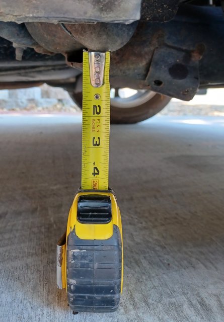

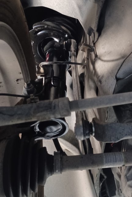

It's back from the shop...lower and tighter but the ride appears compliant...more after I drive it over the weekend. About 7/8-inch lower at the front & about 3/4-inches lower at the rear. Visibly lower in the wheel wells.
Thread Starter #210
Suspension update. The ride is great...yes a bit firmer but I had factory 95k shocks on the car. So yeah the ride improved. Hard to say which made the most difference but the combination of new sway bar links & bushings and more compliant shocks makes cornering tighter (certainly noticeably less roll/yaw), front compresses far less under braking, and far less rattly and jittery (a symptom I have had with the car since I got it with 65k miles), all combine for much more fun. So far, so great! Thanks @scotman!
Thread Starter #212
Suspension update: Lovin' the update. The FR3 springs are compliant but not wishy-washy...big difference in roll and yaw. The cornering is flatter and I feel more confident on turn-in. The shocks do a great job dampening as they should but most notable is the dive under breaking. When the car is weight forward under braking, there is enough piston left to absorb bumps without bottoming and shuttering. Thanks @scotman!

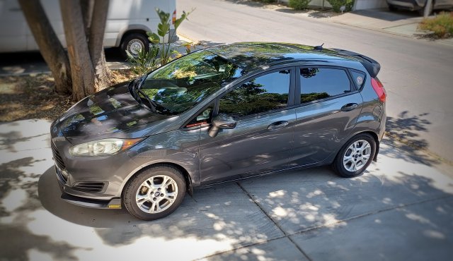

May I ask where you got your wing from? I just got a 2013 se hb and am beginning my build. I found your thread and it has already been extremely helpful and gave me several ideas. Also was it difficult to fit the new wing on?
https://www.amazon.com/gp/product/B079BGY3X8/ref=ppx_yo_dt_b_asin_title_o04_s00?ie=UTF8&psc=1
It was easy. I had to lengthen the brake wires about 6 inches & I PlastiDip-ed in black...otherwise pretty straightforward.

That exact wing has been sitting in my Zamzon wishlist for about a month. The low customer review score had me worried. Maybe I'll pick it up after my front suspension is fixed.
This looks great. I was afraid a larger wing would look crap but this looks good.
Also really dig your painting that lower bit on your bumper.
Thread Starter #215
The wing is an exact replica of an ST wing so it looks great. I got mine from Amazon for the return policy. The price was sure right.
