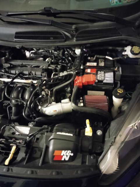

I'm running a k&n intake. It made a big difference on acceleration,mid range and sound. I'm thinking about opening the exhaust a little bit..has anyone done both the mods? Just wondering if it's even worth putting the $$ into it. Is the small hp gain worth it if I'm already having fun in it?

#13
I'm running the k&n intake..it livens it up gives it a deep sound
1,927
#15
The intake noise is where the perception of power improvements comes from. When you look at where the filter is located, it’s being “bathed” in heated air that has been pushed through the coolers.
When you are driving along, as speed increases the airflow through the radiator and condenser creates a positive pressure inside the engine compartment. The location of the open element filter is very close to the underside of the hood insulation panel.
It looks “cool”. But it sucks a steady stream of pre heated air. That anyone would call this design a cold air intake system is almost a kind of ironic joke.
If the intake tube were to have an insulation wrap and extended into the cavity between the bumper cover and the splash shield for the left front wheel, then you would have a cold air intake system. There is room for you to do that tweek.

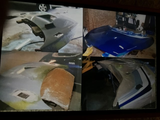

It’s really astonishing how fast the Fiesta gets to maximum temperature! In 2012 I ended up making a ducted and vented hood panel to help bleed off the heat.
Even that extreme measure didn’t work until I wired a jumper switch to the high speed cooling fan circuit.
The fiesta is a bit under capacity in the cooling area. It’s a bigger issue with the ST version.
If a engine mapping reflash had been available, I realized that I would probably have to plumb in an air to oil heat exchanger. The extra oil capacity and cooler might have been a good improvement. That tiny oil to water brick cooler built into the oil filter boss is not very effective alone.
I’m not criticizing you guy’s for wanting more power! I am in your club. I’m just sharing what I have learned from the things I did with the Fiesta shortly after it was released for sale in America.

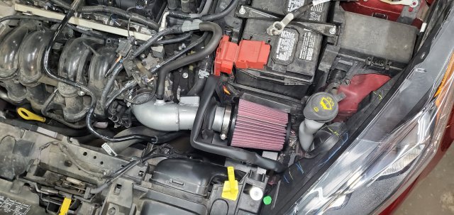

I have the K&N intake and aFe POWER Takeda stainless cat-back. Sounds good but not much power to be gained. They both claim 3-5hp, but I'm sure the PCM corrects any gains.
I'm actually saving up to get the Takeda...how does it sound with the intake?
