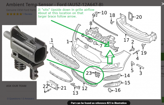

You have a 2017 with a Air temp display on the Dashboard, not being "correct" to what the other Temperature sensors are working with.
The only help I can possibly provide ...
Since in the US it costs about $7 bucks online - thru a Dealer about $20 - but I would recommend that you take some time and look into replacing this part it can give you and the Dashboard possibly even the HVAC unit - wrong information - it mounts upside down thru two "gator" tabs.
Since this thing sits in the airstream - if there's been a lot of road salt, poor cleaning or just plain bumps and bangs on the front cowl/bumper skirt - this sensor can lose it's position, even it's seal and start electrically degrading performance and give you headaches and goofy results from the heater / AC not really working together very well.

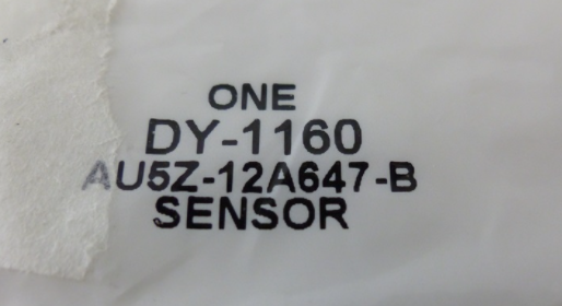

Part # AU5Z - 12A647 - B
Your biggest problem would be in how to gain access to this little part.
You have to remove the front Cowl / Bumper Skirt - Nose and Grille - basically the whole front end trim to get at this little bugger.
You can make a day of learning how NOT to try and do this yourself next time, or try to make a day of learning how the Fiesta is put together so the next time you want a car, you know what to look for...[?|]

That's why I say it's a PITA - the number of pieces that have to be removed, is necessary to get access to a part that weighs less than 2 ounces!
Please don't try to "pry" it out like I did - you can't get enough oomph to press in back into - locked into, place once it's loose - you can crack it trying to do so.
The Front Grille is a lot like Peeling an onion, it comes off in one big shell, but peels off trim pieces layer by layer. If you're not careful you can even damage this trim stuff making the Radiator housing come loose and unsecured - not what you want to deal with or have it hauled to the Dealer - the laughter you hear from their back break rooms can be deafening...
The US version of the Grille is a LOT harder to remove, so it' easier to remove the whole skirt and front trim - to obtain access.
Once you're there, you can relocate that little sensor to wherever you wish - just close to moving air and not directly in the path of debris or sunlight rain and other hazards - it will work just fine.
Maybe if I take off piece 8 I can get to it...just took a look, but wanted your thoughts.
