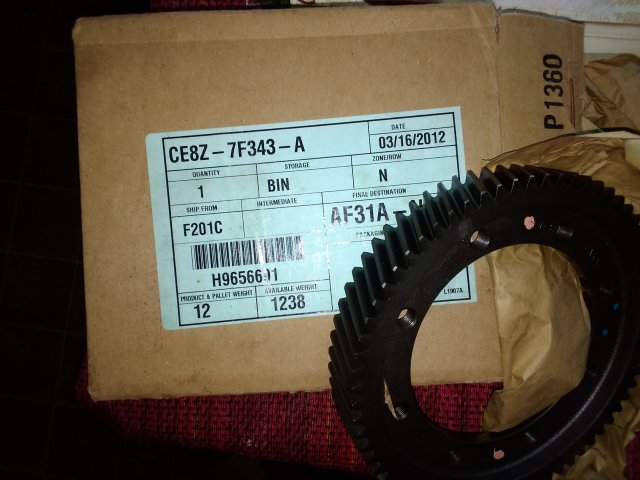

You might want to visit a Ford dealership and see if you can still get this 3.25:1 final drive ratio ring gear. It was offered to buyers on certain 2012 Fiesta SES hatchbacks as means of improving the acceleration. I grabbed one as a service part to use in conjunction with the Quaife differential. But, no performance reflash and improved camshaft kit was ever released, so I shelved it for the future. One of these in concert with the Quaife and some really lightweight wheels and a smooth intake/low restriction air filter element and a catback muffler system might just get you within the margins of expectation of improvement to a 1.0 liter Ecoboost. The only downside is that the 3.25 final drive will reduce the top speed capability. Basically the same as the ST 200 draw back that made that variant quicker but slower. I recall that this part was not over $100 bucks. It should be an easy and totally doable upgrade to the 5 speed box. IMG_20190618_164619.jpg
