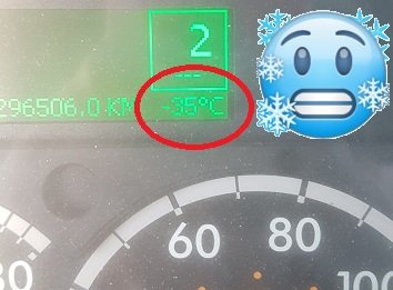

Although the F-bomb starts like a champ in winter weather (-30C/-22F) test passed, this was Friday am about 1 hour into my day at work...
