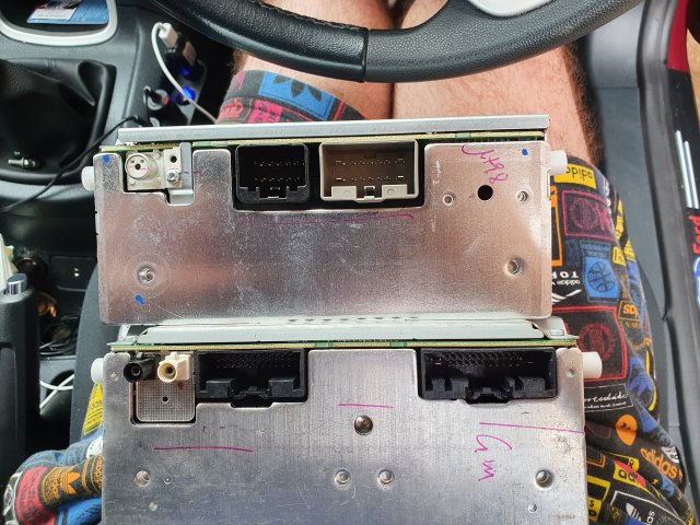

Hiya Guys.
I have a 2010 fiesta fitted with the standard stereo. Ive bought a bluetooth headunit & sony black fascia to change mine over however having removed my stereo this morning the two plugs on the back of mine are a different shape to the ones on the back of the bluetooth headuint. Also the ariel connection is different too( mine has one connection the other one has two small ones) are there adapters available for the two plugs?

Based on the photos, I think the bottom one should be for the facelift version. You might want to get the unit that is for your year model.
912
632
I think that there are at least three different radio-hvac face plates within the mk7 and 7.5 Fiestas, depending on the market they were intended for.
