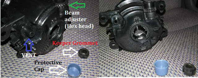

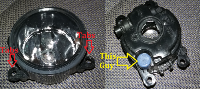

You have to gently pry off the plastic trim cover housing that thing uses - you'll see the fog lamp housing is pretty simple.
The housing I'm talking about is under the main cover for that Fog lamp inset. The outer black part is just the cover - the housing itself holds the light.
Those tabs act a lot like your license plate tag - you have a square hole punched and the bolt uses a square insert that holds the plate to the rear panel.
Just unbolt the lamp - the back side is what I wanted to show you - that blue cap holds the vent - so when you have water in this - you either had a rock gash a hole into the wheel wells plastic housing - or you have a drip line that when it rains it drips onto and into that cutout the trim inserts into to provide a plastic protective cover trim for that lamp.
The clue here is it clear water, not foggy (yet) or has dirt - so it's not throwing water into it - you just may need a new housing for the lamp - something broke it. Recently.
But I'll leave these posted here so you can see the lamp in more detail to help you make choices...
Just make sure you don't have water or dirt building up inside that housing - behind that trim cover.

So this is going to sound stupid. But I took the fog light out, and soaked out the water with some auto detailing rags I had (actually worked very well).
It appears like the previous owner had replaced the lamps (the the damn towing wiring harness pulled on it) and didn't get it in tight, as the water was splashing up through the light hole (kinda surprised the light didn't burst) as it wasn't sealing. When I got back there, the light was jiggly loose (I'm kinda surprised it hadn't popped out honestly) and I could manipulate it around by just touching the cables (which were damp, but that might have been the undercarriage wash from the car wash today)
So once I got the water drained I put on some gloves and checked the light (no signs water ever actually touched the bulb).
I got the bulb back in (I'll need to run the fogs on a road to make sure I don't need to adjust the beam).
I won't know if it's fixed though as the Puget Sound region is in for some sun for the next few days (it's supposed to be in the 70s tomorrow)
one question i did have though.
Is the blue tab supposed to go on the left or right hand side on the passenger side fog light? (If you are looking at it from the wheel well. And does the beam adjuster face the hood or the road?

I believe that the fog lamp housings are marked for L and R positions. I understand that the adjustment screws are pointing downward
1,493
#17
It (Blue cap) orients so the adjuster can be accessed - so usually the mess is opposite - so the blue part is "up" compared to the adjuster location and ease of access to it.
I think of it as "venting" steam - since it rises out of the pot, the blue cap vents above the lamp.
