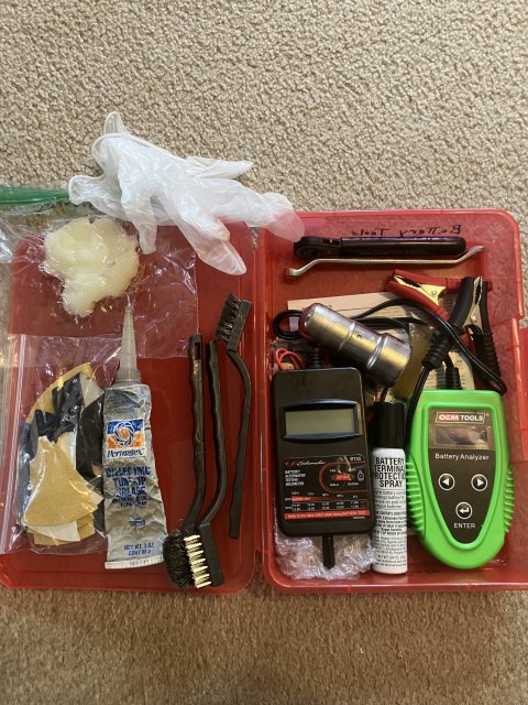

My go to tools for cleaning ground connections. Unless you live in New Mexico, Nevada or Utah it’s something that every Fiesta needs to have done to it to prevent the glitches from turning into a failed BCM or Capacitor. Too much voltage is bad, everyone except for very ignorant people know that. But too little voltage or erratic voltages on circuits that are carrying CANbus signals is also bad. The voltage requirements are low for CANbus circuits but they are very specific and must be stable voltage to carry the signal. IMG_2044.jpeg

Thanks for the picture of the toolset. Since you mention some dry areas, I assume you’re thinking moisture. We’re not much wetter here, but enough so that I’ll need to check the cables for corrosion.
