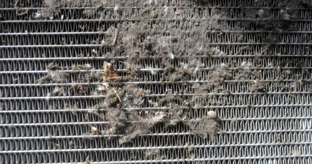

The condition of the radiator and its core - those fins.
When the AC fan kicks in - that is the same fan the Radiator uses to cool the engine - so if the AC for the PASSENGERS is getting warm, better check those front grills and their vent system - I've heard of the front air grille area having slats that may get stuck in a closed of partially open position - when the engine is cold these slats close down to let the engine warm up fast, then the slats begin to open allowing outside air to enter and flow thru these two (AC in front the Egnine radiator right on and to its back) cores get air thru them and take the heat away. (Your model may not have or use this to help the engine warm up - but some of the different trim lines this car has might use such a system)
So, check to see if you have those cooling system slats designed to be closed when cold, but open when it is warm - they are supposed to be fully open in 70 and above temperatures even when starting a cold engine.
You may also want to warm up the car, turn on the AC so the fan kicks on - and take a stream of water and force water to flush out your radiator fins before other problems and winter sets in - this way - that gunk, bugs and road dust, cottonwood and pussywillow lint - moths and pollen - doesn't plug up your radiator or AC core preventing air from flowing thru to take that heat away.

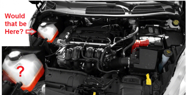

Where is the best or easiest place to pour stop leak?
Now this can create an even more difficult condition, you now have the container - its hoses, and that multi-port connect housing where this tank flows into it, thru the engine's thermostats outlet side, spreads out into the radiator, oil cooler, Heater core and all points south.
Not sure how they did a flush before - but looks like it may need to be done again - this time, removing the container and install a petcock on the lower hose to help drain and backflush this stuff out of there.
Sigh...I've used this and more than once - so the bottle is good for any type of coolant but NOT ALL types of vehicles - this is a concentrate and if not used property - can plug up your car and kill the water pump you're trying to save.
I've used this on a Chevy Nova with a small block V8 - replaced the radiator when I got the chance to do so.
Did this to a Chevy Spint 3-cylinder engine - WAY TOO MUCH - coolant capacity was so small it plugged up in a similar fashion as to your car - required several days of long-term cleaner and several flushing's to remove it and then fix a bad water pump - spent more time and money cleaning up this mess than it was worth. (It's a concentrate - so use only as directed)
Start by emptying the radiator - then pour water thru the coolant tank thru the system then out the bottom - then use a long term cleaner to finish the job then flush it and all debris out similarly as described and then refill with proper coolant - that's all I can tell you - it's the process - don't skip steps! The longer you wait, the worse it can get.
