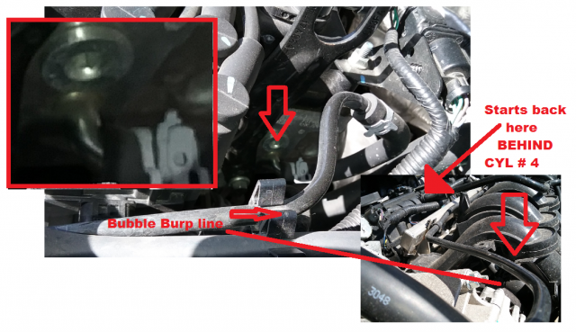

The only other condition would be the radiator - and or - a bubble line - used to burp, purge an air pocket within the cooling jacket that can form towards the REAR of the exhaust side of the engine - this is to prevent a condition of lack of coolant to transfer heat away from the upper exhaust valve for number 4 cylinder when the engine is first started or when it's shut off.
Heat can't go anywhere except thru the heads, any oil and the now standing - coolant - so a condition of a soakdown of heat can "bake / coke" the oil and because of tilt of the motor - eventually will be drained back to the oil pan but in the meantime oil can work thru the seals but the heat buildup can form an air pocket - I believe the temperature sensor is located back there too - so if a CRACK in the valve cover has formed or the PCV valve is not working right - plugged or hose is deteriorated and just now sucks air - oil and vapors from it just sit back there at the rear bank of exhaust valves. So it may start draining to the rear past the upper valve cover - causing a smoking condition you don't lose a lot of oil but its' telling me that the seals are weak.. That means it's close to failing when you don't want it to.
So time to roll up the sleeves and look for plugged or kinked bubble-burp purge line and see if the line is plugged or cut - the air pocket that forms can generate the condition for the overheat sensor to think it really blissfully hot back there until the burp can be performed by the engine itself to move / displace the fluid - there is also a circulation issue too -- several hoses are designed to pull some coolant away one for the heater hose, the other to recirculate the coolant past the thermostat back to the water pump and this burp line to force agitation and circulation - if this is bad, that air pocket doesn't get displaced soon enough to balance the sensors readings and it goes into thinking it's overheating.

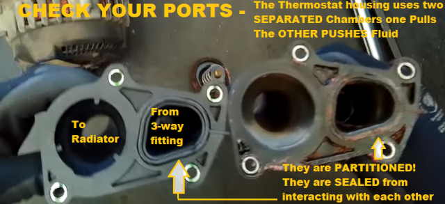

Just so you know - several types of gaskets to handle the thermostat and the housing - one can fit the other and if you don't use the right one - the gasket can block the ports the housing uses to circulate the fluid to get the bulb-thingy to even feel heat...

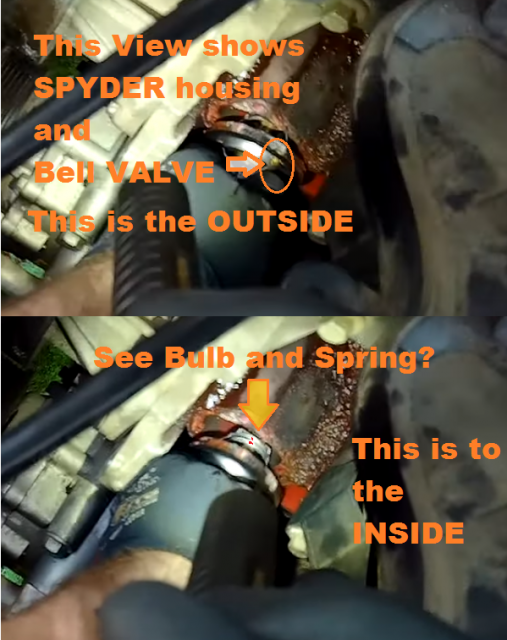

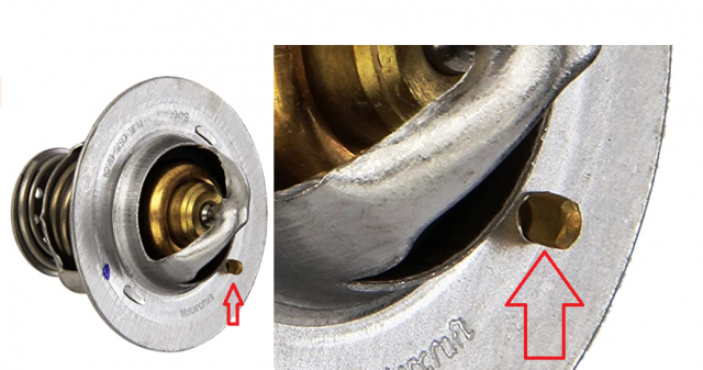

IF you look above - there is a brass stem sticking out of the housing that faces or is-set-to - the OUTSIDE (towards the radiator)- this thingy is a "bell-valve" it allows some of the air trapped behind the thermostat to "bleed" out and away from the engine for coolant to displace the air and keep it from overheating the motor in a given hot-spot - which can cause a warped cylinder head if not kept in check. The bleeder Bubble Bell valve is to the UP position when installed to let air escape but little fluid - it too does have a check "vane" on the opposite side of the stem to retain fluid behind the housing so it can circulate coolant and not draw in air.

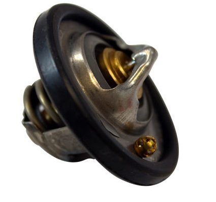

2011-2019 Ford Fiesta Thermostat - Motorcraft RT-1211
This one is 190 degrees...​

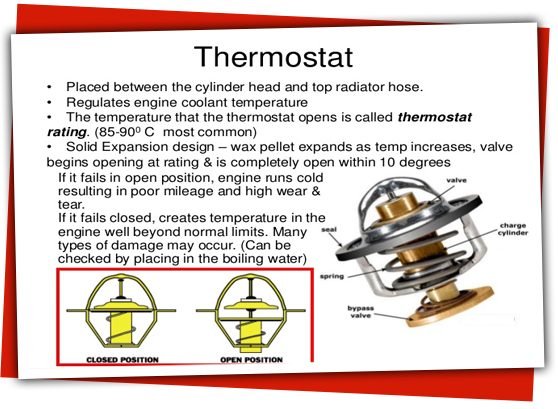

I changed the thermostat myself and when I saw the problem was not fixed I also cooked the old (original) thermostat at home and it opened in boiling water. So the fact that previously installed thermostat and the now new one did not make a difference I think it is not that. Same for its gasket or rather the thermostat housing`s gasket. Because this comes like a unit. U cannot buy just the thermostat it comes with the housing an goes on the block of the engine with 4 bolts + a gasket of course.

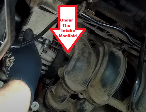

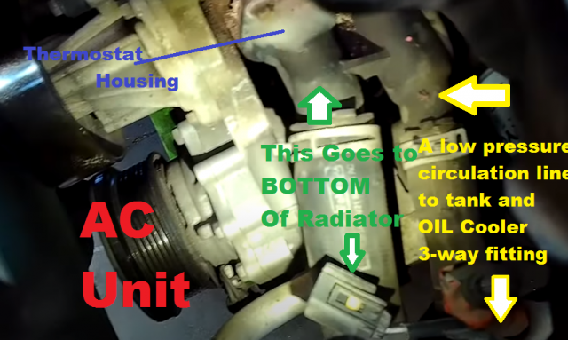

Sorry if some pics are a little blurry, but this area I'm "shooting" the phone camera with is just by the AC and Alternator side of the motor - under the Intake...
So if you can imagine this...
Now on my car...
The reach to pic this is difficult but here are some other alignment markers to help you...

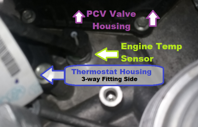

The PCV valve housing is under the intake too - this shot is by the AC unit and you can see
where the TEMP sensor sits - right by the Thermostat housing on the block.

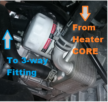

I also have an Oil Cooler...

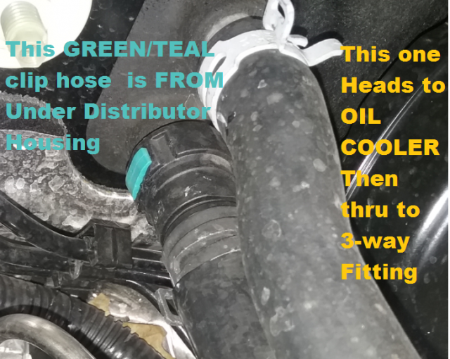

So the circulation here is...
FROM HEATER CORE - DOWN TO Oil Cooler
Then UP to 3-way fitting...
(The low pressure "uptake" line")
How do I know this?

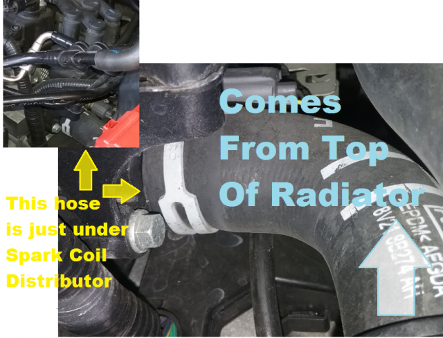

So then the Big hose from the Radiator Top is here...
And so is one of the Heater Hoses that GO to the Heater CORE.
This is pretty much the route it takes...
One more tid-bit of advice!

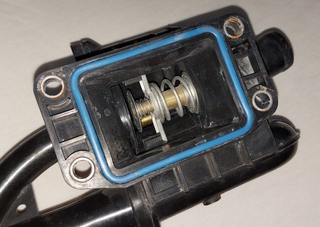

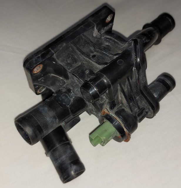

So if I uploaded the pictures correctly. Here`s my thermostat fixed in the housing. So the hoses could not be switched. Its also on the other side of the engine on my 1.4.
