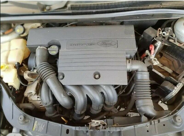

Cn you spend a moment to upload a photo of that engine - we had another member have an overheating problem, only to find out the engine was a diesel - not petrol - motor which just needed to be "regened" as part of the emissions - so their headaches were from the cycling event getting cut off just never completed the cycle.
With the vehicle going into "overheat" - before, you did the right thing by knowing the age of the vehicle - replaced the radiator, thermostat and the temp sensor - yet still overheats - might indicate a plugged hose or bad, mis-laid hose routed and now got kinked - affecting the sensor - or the sensor wiring and even the hoses by it, suffered some type of impact and or failure - so when the service guy replaced the parts, they never bothered to verify the wiring was good ot the pump was working - which now seems to focus more on the Water Pump as having to have failed or getting ready to seize up
Replacing the water pump is the only thing you haven't done.
This is a 2014 and were in the USA - so hope this condition can be resolved by getting your service guy back to it and have them recheck their work.
The car has several variants of engines - mostly 1.4L - in the US - we have a 1.6L version of a similar chassis
Yours should look something like this...​
