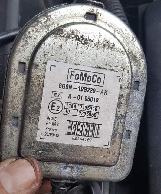

There is a "Battery" icon in mine as well...
So, this occurs when you first reseat (Reset the "disconnect the battery cable" procedure) the battery in the engine compartment. - and after SYNC needs to do a reset or reload of itself...
There is a SEPARATE battery for the PATS and Anti-theft system - the SYNC unit does not use this in the USA - so it shows no battery - the thing is a lot like a car alarm sounder (look up MK7 Battery Sounder) it's an anti-theft alarm
I believe it's this device it "looks" for and shows its icon "battery level" - This was described to me when I was first looking at buying one of these cars and they asked if I wanted to have Pushbutton start or key - I asked for key but also asked why - so they showed off some of the ways these vehicles are more secured
Whatever that means...
So, the "icon" may simply be that it's looking for and has not found that device...
