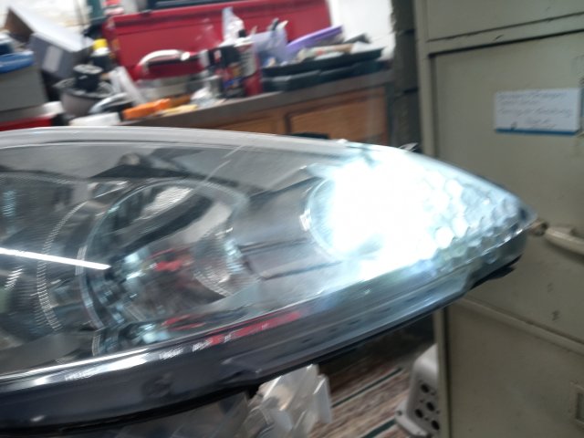

I installed some new Sylvania Brite star headlight bulbs and that has been a big improvement. I would be onboard for a LED headlamp upgrade if i could just purchase the entire capsules and then "plug and play". 20210124_155859.jpg
Member
262
205

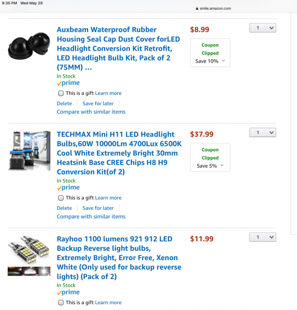

The lights pictured just go where the regular low beams go. The end caps allow the fans to fit. The driver's side cap can remain stock. I haven't done the high beams, and I don't really know what LEDs to use for that.
