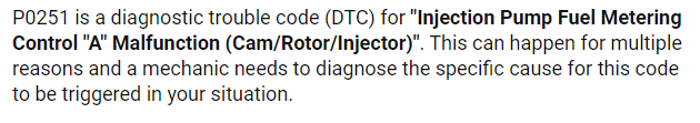

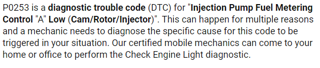

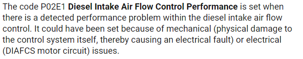

hope someone kind can give a bit of advice have a fiesta 1.6 tdci on a 09 plate never had a moments problem, until it started to just cut out. Crazy things was if I pulled fuses out and put them back in would start back up and go for days with no issues, but got worse until that didn't work no more had fuel filter changed and new glow plugs still no difference, had it plugged in and have had code P0183. P0251. P0253. P02E1 ...any assistance would be most appreciated thank you

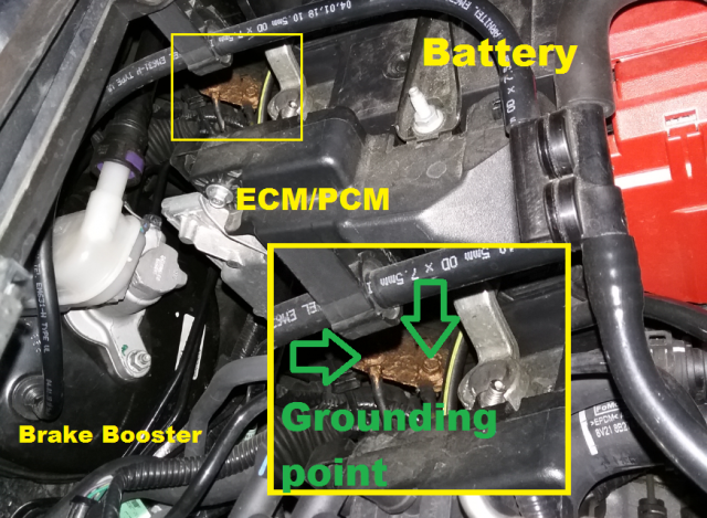

If that doesn't solve the problem, I know several other places that if neglected, can leave you stranded.
One being Chassis grounds.
If any of those broke loose, or corroded away, due to age, can become your symptom!
The "gold color" is from my efforts of using a Copper-based - anti seize compound applied sandwiched under, by bolted connector, back on and then coated with it again - to preserve the connection point as much as possible.
They are located in various locations around the engine compartment and on the engine - several right by the battery and others by the Right Side Headlamp just under it's housing meaning you have to remove the headlamp to get at it..
