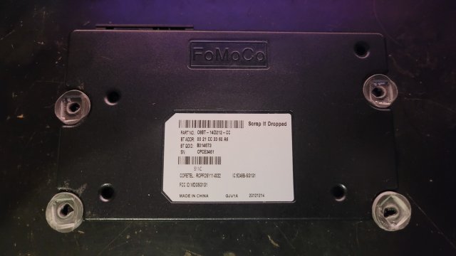

Hello, I am the owner of a 2013 Fiesta Kinetic Design titanium and the sync 1 module was damaged by water. My fiesta is a mexican unit, so it should be either the same or very similar to the american fiesta. Over here my OEM replacement sync module costs about 1000 usd and for some reason there are no used ones. I am not willing to pay 12% of the cars value for just a module. I would love to know if the module is replaceable by another one with a different part number (Mine is C8BT-14D212-CC). I found in Ebay lots of modules with the part number D1BT-14D212-CC (Is very similar but misses a secondary mini usb port which my module has but my car doesnt use) and cost no more than 80 usd. I also found lots of Sync modules in Mercado Libre (Argentinian Ebay) with the part number AM5T-14D212-KD, BM5T-14D212-KB or FR3T-14D212-GA which cost no more than 70usd and come from the brazilian manufactured fiesta. All these modules also lack the exrta mini usb port, but once again, my car only had one mini usb connector for the module. Is there any way to know if they are interchangable? Here's the module:

If i were you I'll try to see how damaged the module is to see if it is repairable (can be some component pins that have rusted or some tracks on the board), if not, i'll just try combinations of sync models with your radio, as probably the extra mini usb is either a service port or a usb for an extra feature other fords or TOL fiestas have. If they dont work i'll just buy f.e the brazilian fiesta radio with the brazilian sync module, shouldn't have any problem technically speaking...
Have you checked the scrapyards on your surroundings looking for parts too? maybe you're lucky to find a mex fiesta with the same module yours had.

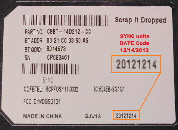

There's some stuff that you might need to know to help you in your search - because to make this more of a "Drop in" the technology around it needs to be kept similar - else it will fight you or not even be recognized due to the differences in the CHIPSET as well as the Programming it needs to be seen and work with the system it's going into.
You already know the part number, but the BT identity (no; not referring to the address - just having BT compatibility) and FCC ID - should be kept the same - this tells you that you have the same technology as the broken one - and having a unit closer to the Date code helps with the version and the last update it could have in it before it was installed in the other junked unit.
In another thread, you may also encounter DTC and error codes during this install - the SYNC unit "copies" and even becomes the sole heir to - a lot of data when the car sits. So this may have crash data as well as the other vehicles' configurations and error DTC codes stored in it - so to keep this simple - just be ready for a fight during the install.

The PCB is completely eaten by rust. Previous owner (My mom) didnt clean sunroof drains all that often so lots of water came into the car.

First of all thank you for answering my questions and happy holydays! Secondly, I'll have the chance to travel to the USA in february and I might be able to take an american sync chip back home. Now the thing is there are no similar part numbers. For some reason ford decided to give each country a different part No. So my question is, if it has both bt compatibility and the same FCC id but a different part number with a 2 month difference in manufacturing, would it work? Or is this already too specific of a question 😅? The one that i found is DE8T-14D212-AA. Its from an SE model whilst mine is a Titanium but both the USA and Argentina recieved mexican fiestas back then so should come from the same factory line.
When you have something like this - it is hard to tell except to try.
2 months is pretty close - congratulations - it might work, but I cannot expect miracles.
The units will need an environment that lets them get "taught" by the ECM/PCM and any system on the CANBUS and LIN so the SYNC can receive messages and know why it's receiving them. This is part of the burn process that takes the VIN of the vehicle and the known ROM - overlays it and uses E-Prom methods to generate the template and working overlay of the Modules functions masked and the ECMs' ROM burned around along with the other indexed addresses so the SYNC unit becomes seamless to the vehicles systems and can work the Console menus without a glitch.
