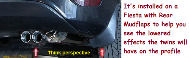

      • In light of lowered notes, the pipe will have those puffs of exhaust gases passing under - there is no collector - so that noise will simply be a vibrating pipe under your seats - the noise will be towards the back - and if not done right will make for a noisy commute, an embarrassing sound effect and deprecate the investment your car is.
  • I'm not saying you can't - just be ready to have somewhat of a mess on your hands if this turns out to be an epic fail.
Compare the sizes - determine if it's Strong enough and durable enough - for if you're into low rise - rides - then potholes and road debris are going to be a major worry - did I forget to mention crossbucks?

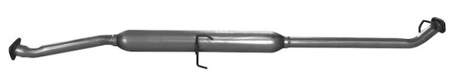

Now, if you're inclined and have a good welder nearby, they can put the pipes on, but what you may want to look more for is a Resonator - a extra section of tube that's got more area to collect and utilize those puffs for extra effect.
The sausage thingy the middle is what I'm talking about - the Fiesta already uses a resonator but designed more for collection (It's pretty short and not designed for tones) and it's for the backpressure that would build immediately upon acceleration - that is usually what kills any effort to make a system have a lower tone - what works against you is the backpressure - it tends to wash out any ability to collect and time that energy in straight pipes - so you take that backpressure and use it in the system as a means of developing a tone.
The problem with a Fiesta is the dynamics of only so much air - so the range or span for tonal range is limited by the airflow present - so lower notes require more air than the system can supply - so you get a flat note - not a dynamic range and tonal range for tune. Thats the reason for that extra wide tube to help you develop the notes.
