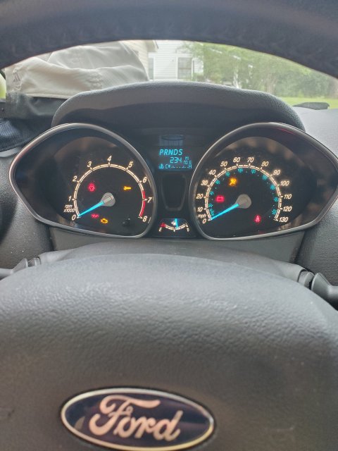

I've had my fiesta se for a little bit now and recently the wrench light popped up, and then days later it won't even crank. I can't even hear the sound of an attempt it trying to run. I'm sure I'm not the only one who has been in this situation, so could yall help a brother out from yalls previous experience? The picture below is the only thing that lights up when trying to crank it.

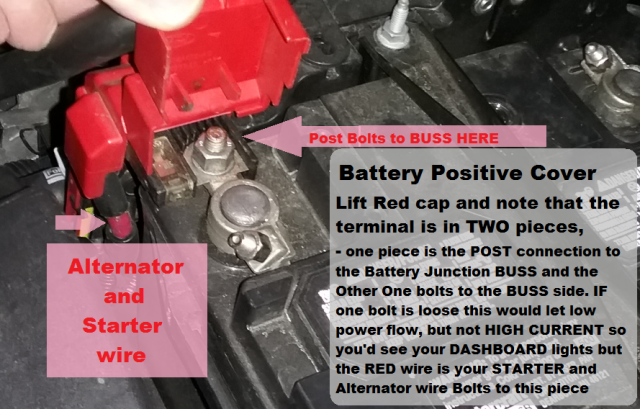

Figuring this is a 2016 or later Fiesta - check the battery - a previous post shows how to remove that RED cover and you'l need to check the condition of that cable.
Look at your Battery - check THOSE cables and connections and connectors..
