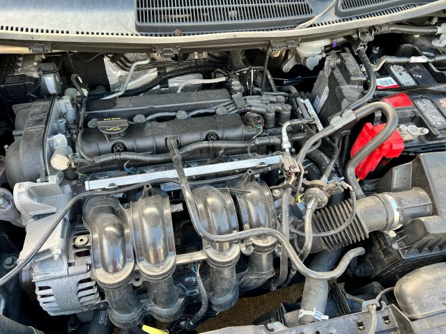

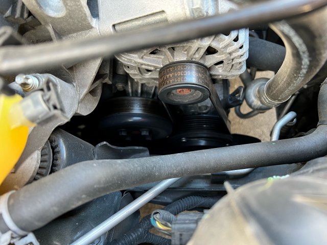

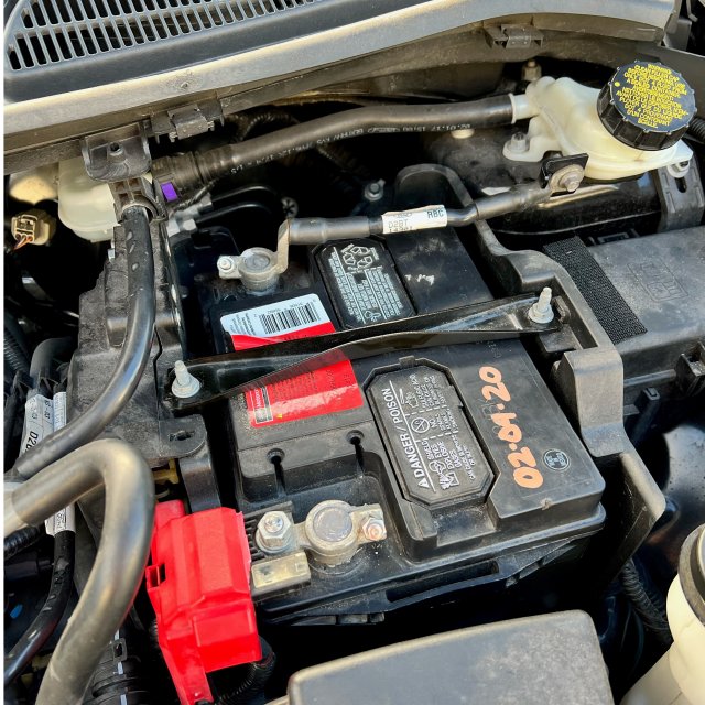

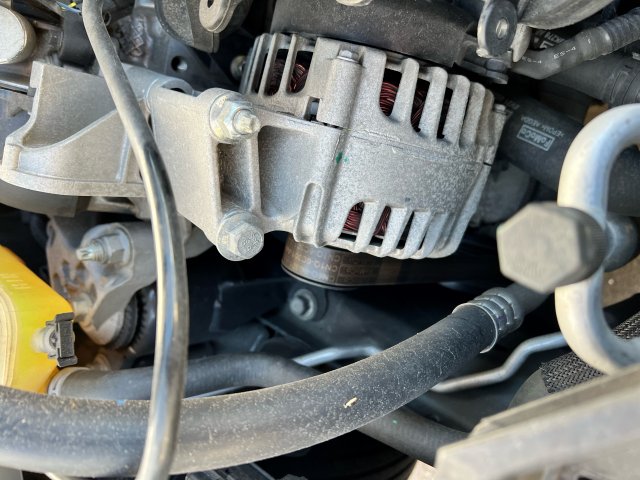

When the car is jumped, and or battery is charged the dash doesn't flicker. I think just me trying different things drained my battery and it sitting so that's why maybe they flicker oh and also my touchscreen radio too. If i start the car but not fully the dash lights stay fine. If charged/jumped it'll just keep cranking. I have check engine, wrench, oil, and I cannot remember the other one. My plastic cover for my positive terminal came off you'll see in the pictures from my own doing it snapped off easily for no reason lol. The crankshaft sensor I replaced didn't seem to do anything. Although the previous one wasn't looking too good when I took it out:

Alternator & Belt:

My Engine and Battery:

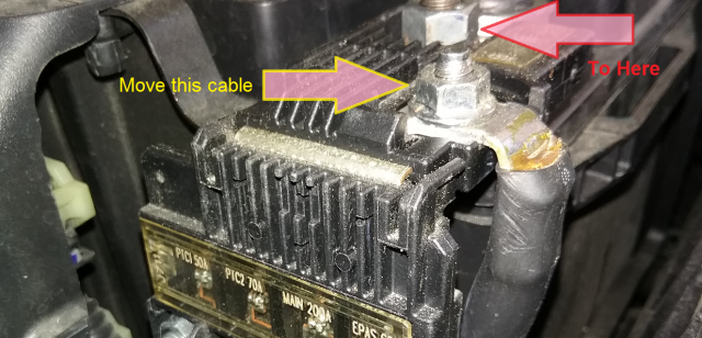

Finish removing that red terminal cover, then see if the starter cable heading to bolt on that big fusible link can be unbolted and re-bolted directly to the post bolt on the battery see if it can start.
If it SPARKS when you do this - STOP! It may mean the Starter Solenoid combo is broke - it can be shorted - the fusible link blew to save the rest of the system.
You may need a new starter.

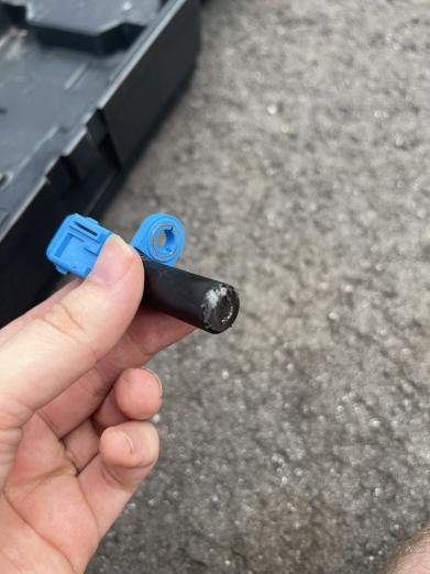

Looks like it's the flex plate flywheel. It's pushing up against the crankshaft sensor and the old sensor is chewed up.
1,455
1,140
Wonder how the bottom side of the motor looks, because if it's got road rash - its a strong clue as to @jwardweb approach, something certainly jarred it.
The other thing too is if the radiator and shroud - it's integrity - if it's not flying pieces of itself into the motor when the fan kicks on.
The reason I say this is the bumper can accept some abuse and rebound for some more, but the parts inside the past the bumper - if the, strike, bump - hit or whatever happened - while the engine was running - you experience this.
I've seen fan blades chunk off when the owner hops curbs when they had the AC on in the process - you can hear the blades scraping against the radiator. Leaves a plastic shard - and eventually a spray of coolant into the front windshield.
