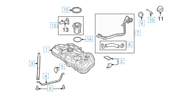

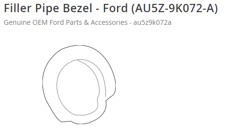

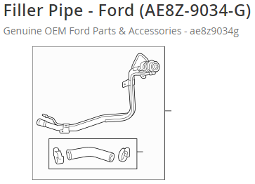

Ok, here's some details...
Part #7 is a two-piece assembly - Part #8 contains the "gasket" and #9 they call it a Bezel
